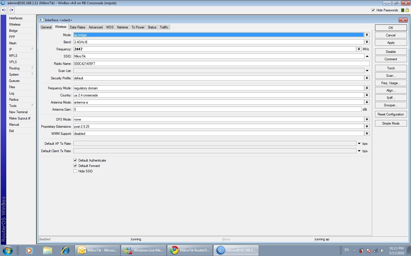

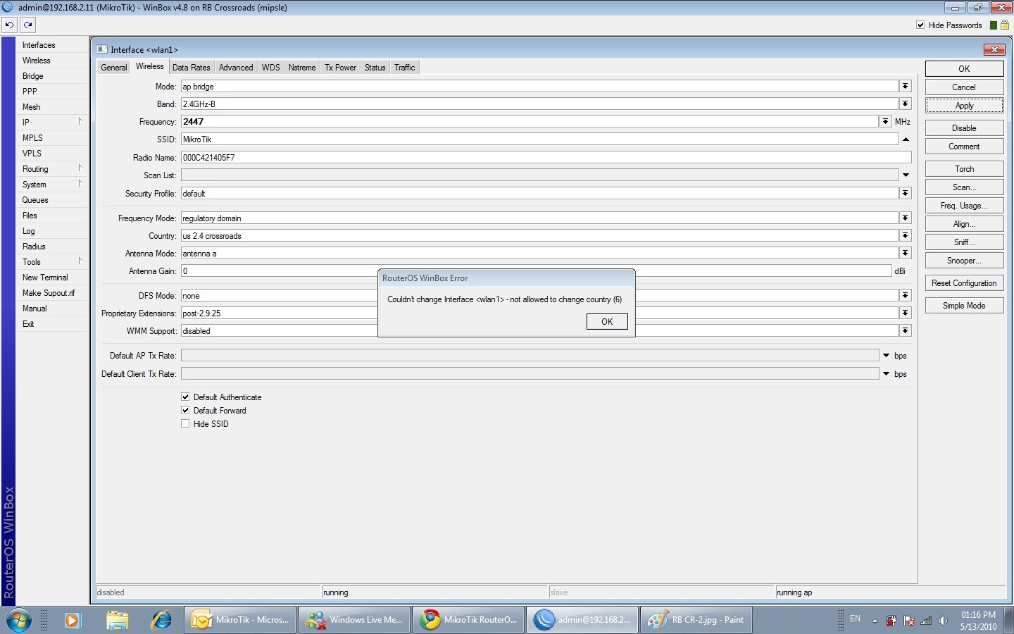

i have like 6 RB CR and it was V3 then i upgrade it to V4 assuming that i can use the super channel but it i dint work so i did upgrade to extra channels also i still have the same issue i cant change the country or the frequency mode it says not allowed
my country sets to US.Crossroads and the Freq Mode is regulatory domain.

I doubt that. You had to configure it:
  1. After upgrading to v4.9 set wireless mode to “superchannel”
  2. Choose a new frequency
  3. In the client device, add this frequency to the “scan list” setting
Thanks for your replay
please see the attached photos and it is the same after i upgrade to 4.9
You probably have a Crossroads from a protected region (USA). In order to void all locks, and use it at your own risk and responsibility, reinstall it with Netinstall and you will be free to use all settings.
