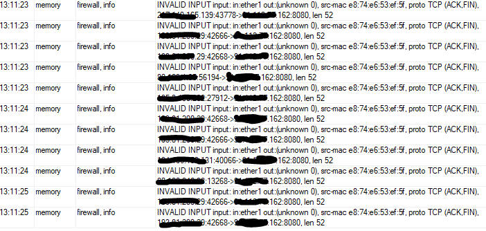

  • many droped packets from known ip addresses due to invalid state (tcp ack/fin) on port 8080, these are from unifi devices

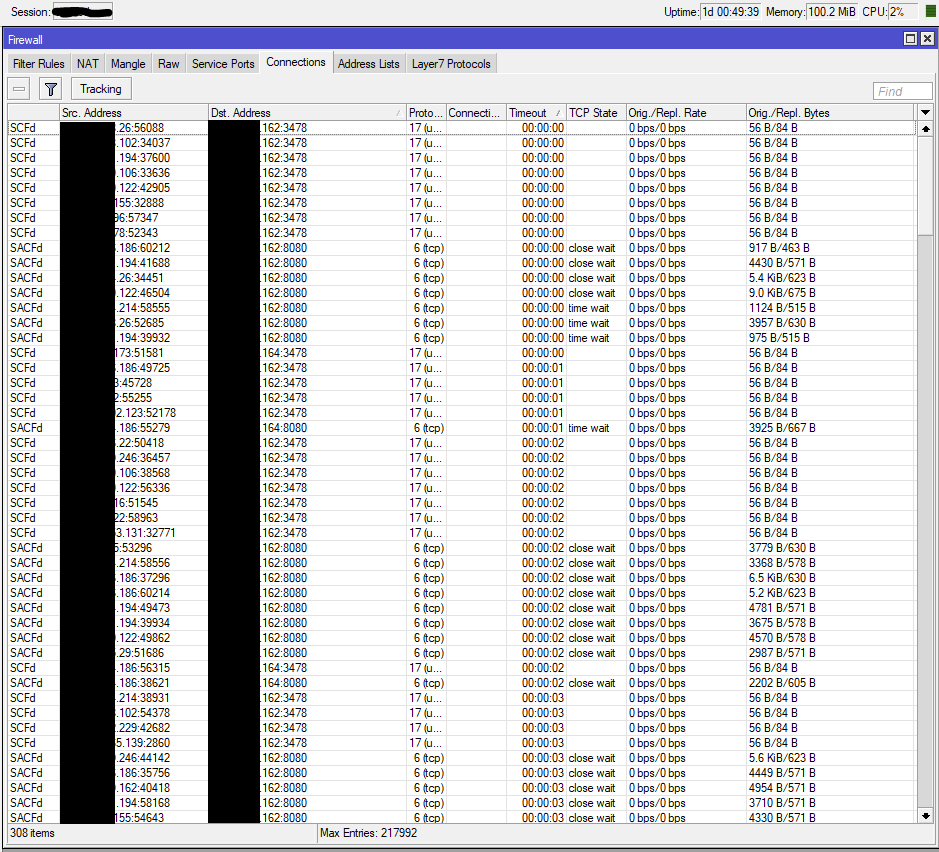

  • connections (around 300 items) shows many tcp close wait to x.x.x.162:8080 from customer sites

add action=drop chain=input connection-state=invalid log-prefix=INVALID

Update: Tested with a second firewall (Zyxel USG20) on the modem and configured it with the ip dedicated to the unifi controller. Interestingly the problem persists on both routers now! It seems like that the modem only can handle a couple of new connections and so both routers drop out
Problem solved by changing the modem from pirelli adb to a cisco 800 series …
