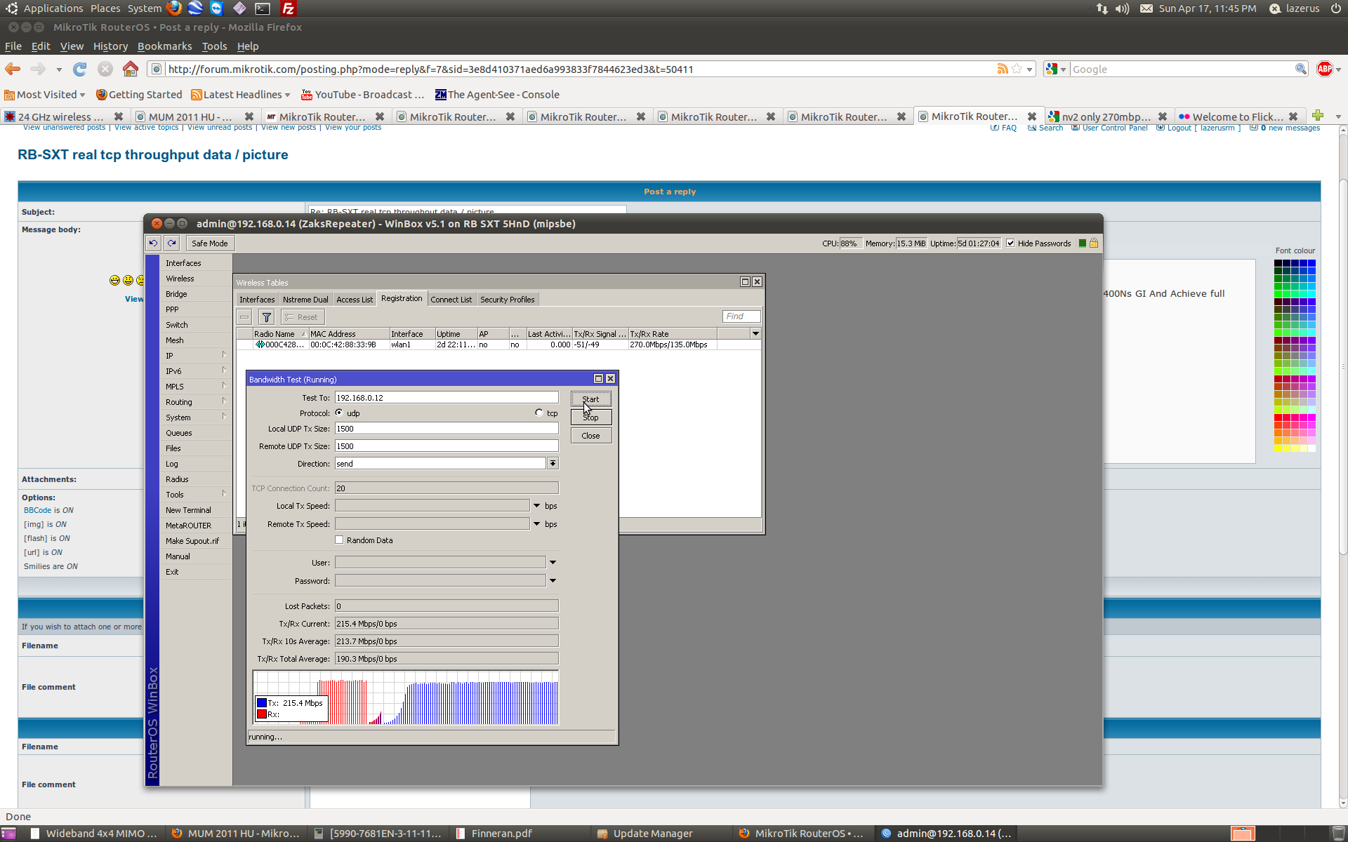

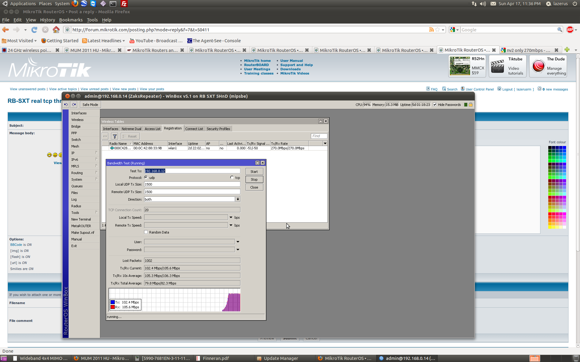

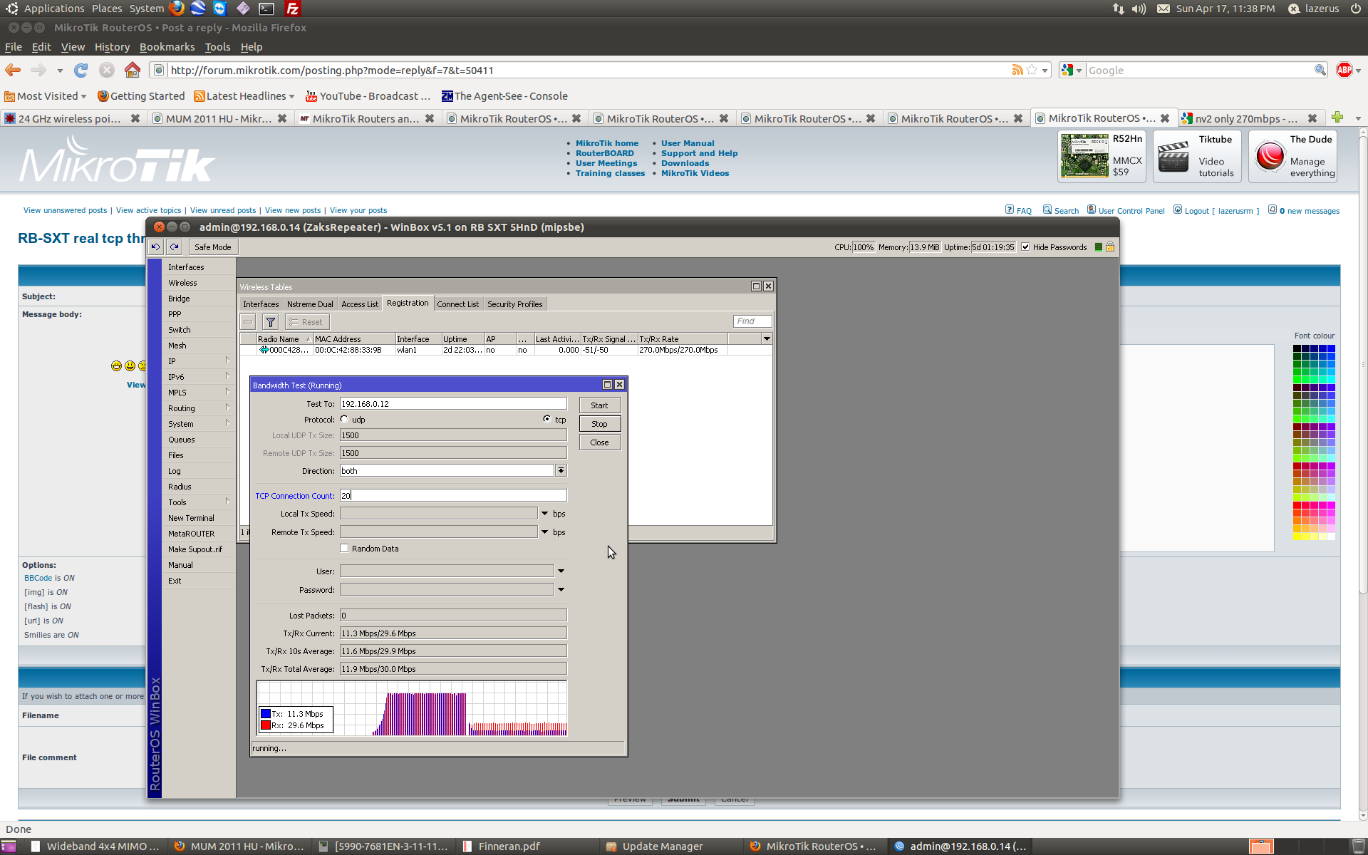

HI there,
I just my sxt setup, but I can´t get more than 36MB bandwidth test. What happended to the 200mb transfer rate ???
Is there any special of setting up the SXT routerboard as far as configurations ?
Thanks.
BTW. The ptp it is only 1km.
The HT-Extension-Channel defaults to OFF. That may be your issue.
regards/ldv
Yes, you were right. I turned them on and it went up to 270mbps/243mbps tx/rx rates.
I still trying to get it to 300mbps.
With the RB-SXT
–If you use NV2, Remember it (for now) Requires a GI (Guard Interval) Of 800Ns, So that means MAX. Negotiated Air Rate is 270Mbps. With Nstreme you coan use a 400Ns GI And Achieve full 300/300 Air Rates However, The SXT Has a 100M Port, so is not necessary / important to use Nstreme for that reason alone. I’ve also noticed that it is common for the SXT to drop lower the rate when not much bandwidth is being used, and then will switch to a high modulation as more traffic flows.
