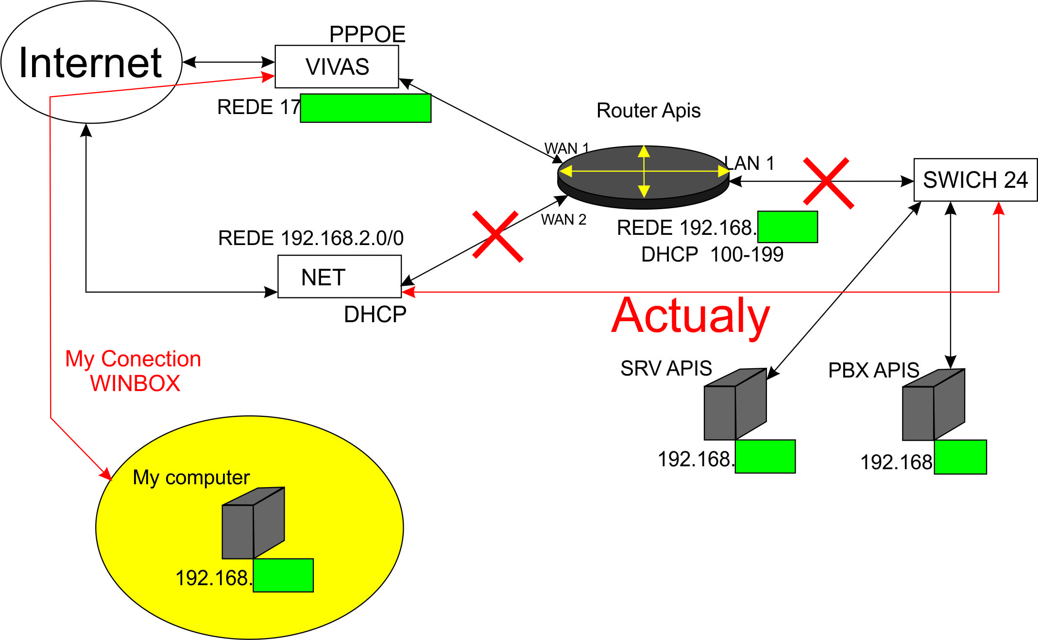

No, I created an access via winbox and gave preference to my ip which is fixed. My company is running with another ISP, I created this RB with two WANS, for redundancy. however, access to pages stopped, that is, even with two ISP’s, they did not access web pages, as if it were the lack of DNS, although RB announced the DNS. so I decided to leave my internal network directly in MODEM, until resolving what is happening with this RB.
I’m afraid I need a drawing to understand what you explain, but I’ll try without it first: if I get it right, when it didn’t work, the LAN side of the Mikrotik in question actually was not completely disconnected as I understood from your Original Post, except that only the PC from which you manage it using winbox was connected to the LAN interface of the Tik, correct? And the WANs were connected to two different ISPs.
Next, what exactly do you mean by of “internal IP”?
For me, “internal IP” is on the LAN side of a router, even if it is a public one; similarly, a private IP (i.e. an IP in one of the RFC1918 ranges) may still be an “external” one when it is at the WAN side of a router.
Thanks for reply!
My drawing to the current RB is this attached, I don’t know where this MAC comes from, since my network is not connected to the RB, and this mac tries to access this ip that would be on my internal network. the Fact is that if you connect via LAN (internal network) there is no way to view pages as I described earlier, the services that require ports work normally.

OK. I am pretty sure these “hack attempts” are unrelated to your issue, and that they have been there also before the problems with viewing pages started. But before these problems started, you had no reason to take a close watch, so now you’ve made a conclusion that the two things (impossibility to access web pages by their domain names and those incoming packets) are related.
So I assume you access, using Winbox, the public IP of your RB assigned by Vivas on the Vivas PPPOE interface, and that either your firewall on the RB restricts Winbox access to a few public source addresses or that you use a VPN tunnel. So it should be safe to post the export of your configuration even though you have leaked the Vivas public IP unintentionally. So if you need more help, please do that, following the hint in my automatic signature here below. Some sniffing may be required later on if the issue is not in the configuration.
Coming back to the log rows you’ve shown in the OP: the rows that show source MAC addresses correspond to IP packets that came as a direct payload of Ethernet frames. The thing is that the IP stack of the RB’s kernel sends to chain input of the IP firewall also received packets whose destination IP address is 255.255.255.255 or a broadcast one of any subnet that is up on any interface of the router, no matter to which physical interface such packets have arrived.
And 192.168.0.0/24 and 192.168.1.0/24 are probably the most used private subnets in the world, so it is nothing unusual that you have “randomly chosen” it for your RB’s LAN, whereas some Windows device in the same L2 segment like your WAN 1 Ethernet interface has “randomly chosen” it too. So it is either an issue at the Vivas side that they allow Ethernet frames to leak from one client to another, or an issue at the Vivas side that they connect their own Windows devices into the same L2 network they use for PPPoE connections to their clients.
As your RB is (most likely) not bridging traffic between WAN and LAN, RB will not leak these netbios packets arriving via WAN 1 to 192.168.0.255 to the LAN.
Regarding the last row in the OP, could it be that you were copying the log manually to the post? Because if the source port and destination port were actually both 5678, this row would be showing a MNDP (Mikrotik Network Discovery Protocol) packet, which seems very likely to me as the source MAC address is a Mikrotik one. So again, it may be an own Mikrotik device of Vivas, or a Mikrotik device of some other Vivas client which is connected to the uplink and neighbor discovery is not disabled on the interface to which the PPPoE client is attached.
All the rows not showing source MAC addresses represent packets that came via the PPPoE tunnel, I’ve given you the details in my previous post.
