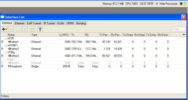

We are having issues with the forwarding capacity of the RB1000. I was under the impression that that model would push roughly 1.0GBit/s @ 64byte/packet. We just had a link in a ring fail and as a consequence we doubled the traffic going through a single RB1000. The router shows 100% and adds about 30-80ms of latency to the traffic when the total load approaches 650Mbit/s. This is internet traffic with some VoiP, but the avg. packet size is closer to 1500 than 64. In any case there is no firewall rules or mangles, all the router does is forward traffic and run OSPF.
