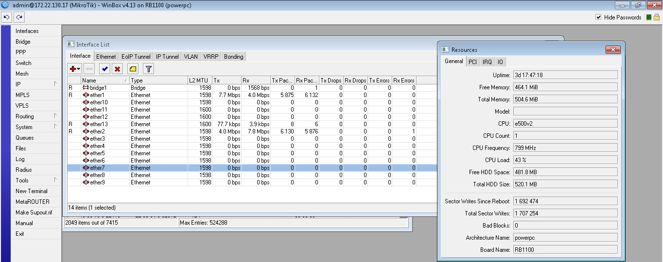

Excuse me for not thinking before about that but here’s a print screen of the traffic/cpu usage. Now it’s 9:35 AM and the gamers are sleeping, this is why the traffic is so low. Yet the CPU usage is abnormally high.

Seems that something is seriously wrong in the config itself if you get that much CPU load under traffic so low.
