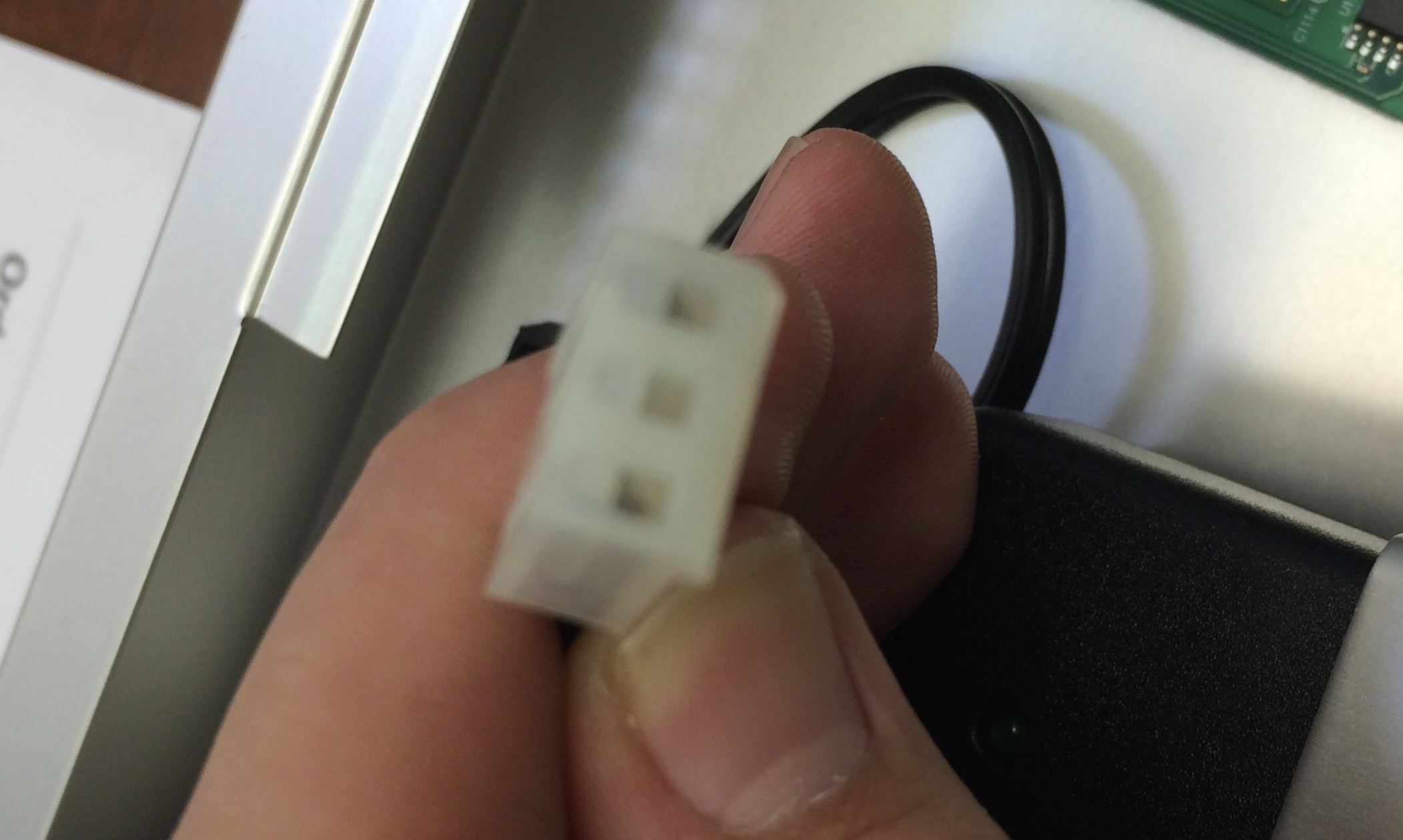

I have a DC only site that I want to use a RB1100AHx2 at. I need all of the ports including the port 13 to be Gigabit. I tried powering via PoE and port 13 will only do 100FD and not Gigabit when powered that way.
Does anyone know what the plug on the end of the power supply inside the case is? The manual references it as J11, but for the life of me I cannot find the plug online. I am looking for a source for that plug before I just cut the power supply cable off and use it. I called my standard Mikrotik supplier and they did not carry it no know what it was.
It looks like a Molex 5.08mm or 0.2" pitch.
http://au.rs-online.com/web/p/pcb-connector-housings/5249935/
Often you’ll find the connector part number molded into the connector in miniature.
I suspect that if you used the right kind of power injector, you would be able to link at gigabit on the PoE input port. http://routerboard.com/RBGPOE
