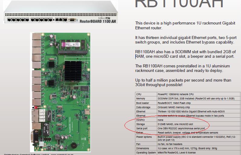

Here’s the problem I have with Mikrotik:
  1. nowhere in the brochure or any distributor (strakwave/roc-noc/balticnetworks) site states that it’s limited to only 41.7MB NAND storage, if fact neither AH or AHx2 brochures state the size of NAND
  2. It’s advertised as “extreme performance” vs RB1200 “affordable device” which has got 64MB (based of the info from the brochure)
  3. Until recently it was said that it supported 8 MetaRouters
Here is the info I was using and the latest pdf http://routerboard.com/pdf/348/RB1100AH.pdf from your website is identical except suddenly no NAND value specified. Has there been an issue with the NAND chips I wonder ?
If indeed my info is for an old RB1100AH then the new one should be listed as a Rev2 on the brochure (and actual product) and specify current NAND amount as we need that info for our customers.
And to make matters worse the same RB1100AH won’t work reliably with a microSD card !! The microSD dissappears when you do a soft reboot. Only a hard power cycle will bring it back. Tested on Ros 5.14/FW2.39 on 2 x RB493G and 2 x RB1100AH Rev2(LOL).
A shame the RB1100 has less NAND than an RB493G (128MB) or RB450G (512MB NAND - for now).
Product was replaced by a new one, brochure was updated because of it. CPU was also changed, as was motherboard design.
Was it intentional for the updated brochure not to list nand storage capacity? It seems that many who purchased the revised RB1100AH did not expect it to be only 41.7MB
Some times, based on stock changes, we might introduce a bigger NAND than 42MB to some devices. As the NAND size isn’t a big factor for running RouterOS, we decided to not show it, as this could vary sometimes. Of course we could include the minimum, but most router manufacturers don’t list their NAND size anywhere. Always assume that “Enough” NAND is installed to run RouterOS.

The new RB1100AH and x2 do have a Samsung 64MB Flash chip on board. All I can guess is that it is not fully decoded. The engineers didn’t have enough address selects available so they made do with available resources and we ended up with 41.7MB.
Granted, the new RB1100AH came in $100 less than last year’s model. But this type of penny pinching seems a bit careless. Especially if you can’t fit Dude and other advanced packages on board.
