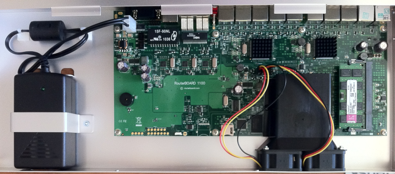

I just got my shiny new 1100ah and noticed immediatly the bypass switch Is this only available with switch, or can it be available via power off, router failure, or programmed into ROS. I can see this would simplify VRRP wiring. Be useful as in a transparent proxy etc.
Also can the POE be used as a backup power supply? i.e. If I plug power into both the back and POE will it fry something? If I unplug one or the other will it keep running?

most of new RouterBOARD models can use PoE as backup power supply. Ie, use power both at the PoE port and at the 220V jack, and if one power source is gone, board will continue to work on the other. This is true for the RB700 and 400 series, will check about RB1100

Yes, this is true to all RouterBOARD devices which don’t use PoE selector jumper (RB532 or RB333 was the last, can’t say for sure), ie. all current models.
It will select the highest voltage of the two. There will be no reboot if you unplug one of the cables. Try and see.
