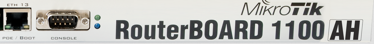

I assume you’re using ether13?
Which OS? physical install or it’s a VM?
Have you tried using a different laptop? A different ethernet on the laptop (USB for example)?
Yep, I don’t even see the bootp packets unless I connect to ether13. :3
