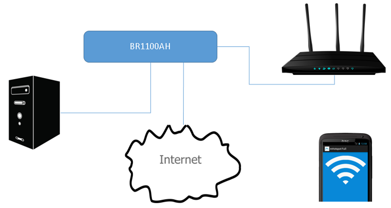

Yes that’s what i want , to connect a PC physically to the BR1100AH , but not visible to the internet , it’s just locally and the user can connect to the internet or to the local web server, there is a internet WiFi network connected to the BR1100AH ,so the WiFi client when he connect to the network he can use the internet or to go to the local web server.
so from my cell phone for example i can connect to the internet or to the local web server ..

Hello , sorry for be late,
I try to do static DNS it works for another wireless computer : From my android phone i can access to my web server that also connected to thw RB1100 by wireless , it works , but i can’t do it to one of its ports (eth01,eth02…etc), that’s mean if i connect my (PC) web server by Ethernet cable i can’t access to it …
any tips?
Thank you
Is the PC in the same bridge as the Web Server?>
