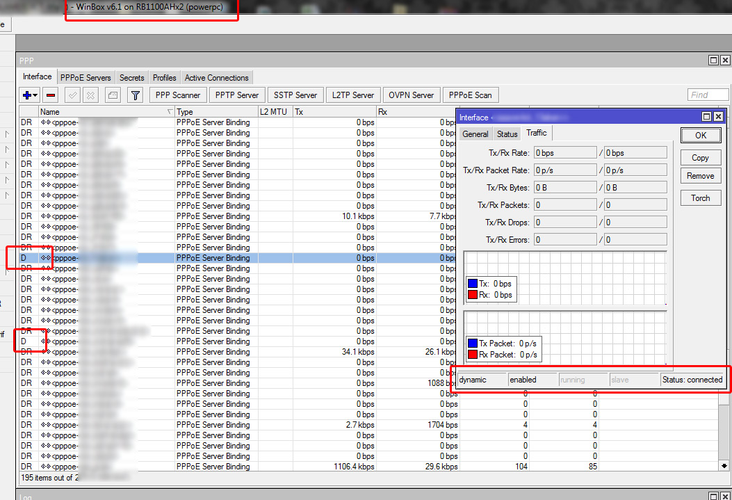

I have 3 Mikrotik Routerboard and using 6.1 RoS .
on RB1100AHx2 Connected users with PPPoE , for random users connect without running and can’t access to network .
I have a RB1000 on ROS 6.1 without this problem :
See Attached image :

I have one RB1000 and one RB1100AHx2 , on RB1100AHx2 give this problem .
to fix the problem I downgrade the firmware to ROS 5.25 .
