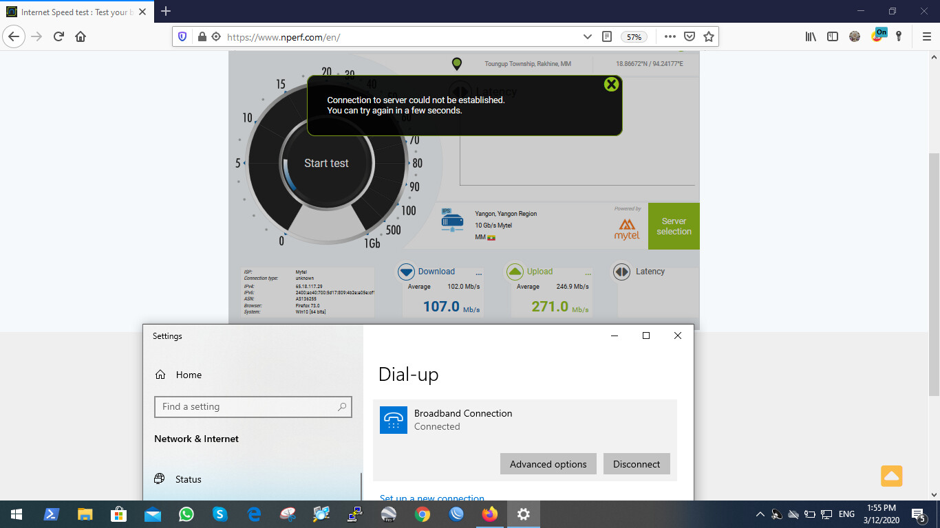

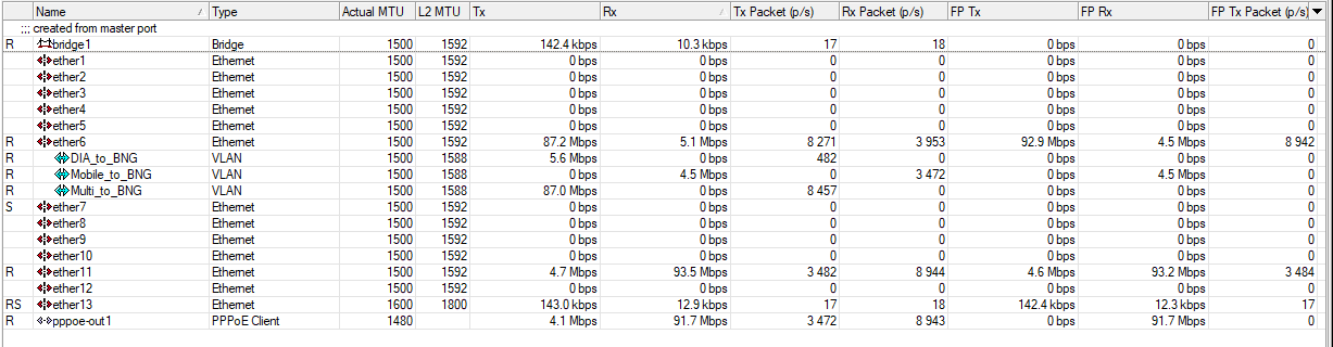

I recently upgraded my internet connection to 300 Mbps. The thing is i can not get more than 150Mb/s on my RB1100AHx4. . On both i get 7% CPU around 150Mb/s . Am i doing something wrong or is this a hardware limitation ?
pls help the full bandwidth get.
Thanks in advance for any advice.
