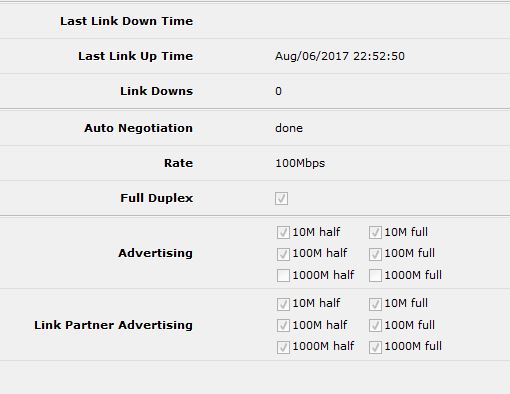

WEBFIG status of ethernet port

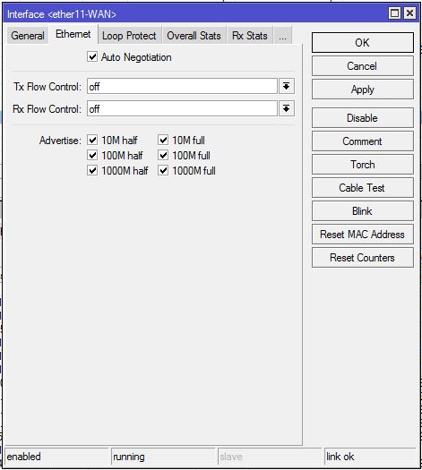

Winbox ether port setting

Support seemed confused asking me to enable “1000M-full” which can be seen in the image above and that I also provided.

There is no bug here. Your Webfig and Winbox are opened at different location, different menus.
Webfig shows interface status.
Winbox shows the settings you can set.
The question why your interface is linked at 100Mbit is different, cable, other device etc.
The problem is the setting is to advertise up to “1000M full”. Both the RB1100AHx4 and connected devises only see an advertised speed up to 100M. Winbox status also shows only 100M advertised speed (not shown in these images). The connection actually connects at 100M, why? Cables checked (1m long), changed and alternate devises tried.
