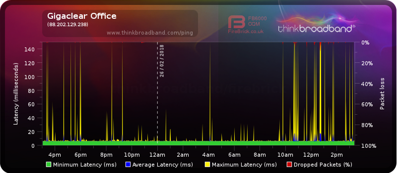

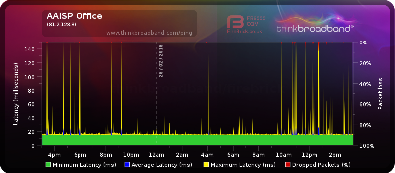

I have two completely independent internet connections fed into my RB1100AHx4. One is a 250mbps up down “gigaclear”, the other is a 40mbps download 5mbps upload “BT” connection. In everyday use only the gigaclear connection is in use, the other is an on standby backup
I have both connections monitored via each connection to show ping response and latency (see attachments). You will notice there there some ping spikes which are lining up identically. Therefore I have come to the conclusion that the RB1100AHx4 is causing this - any ideas why? Indeed during web browsing there are occasional hangs - hence the investigation.

The 1st ISP Gigaclear is connected to port 1 and the Second ISP AAISP / BT is connected to port 2. However both connections are not used at the same time, the second connection is only a backup so it’s only used if the primary fails so I don’t think its a switching chip problem.
The gigaclear has a custom FTTP router.
The BT has an Openreach VDSL modem
So I think it rules out both providers having PUMA chipsets, and surely they wouldn’t exhibit the latency spike at exactly the same time as shown in the graphs?

However if you look at the graph the latency spikes continue throughout the night, when there is virtually zero traffic running through the system.

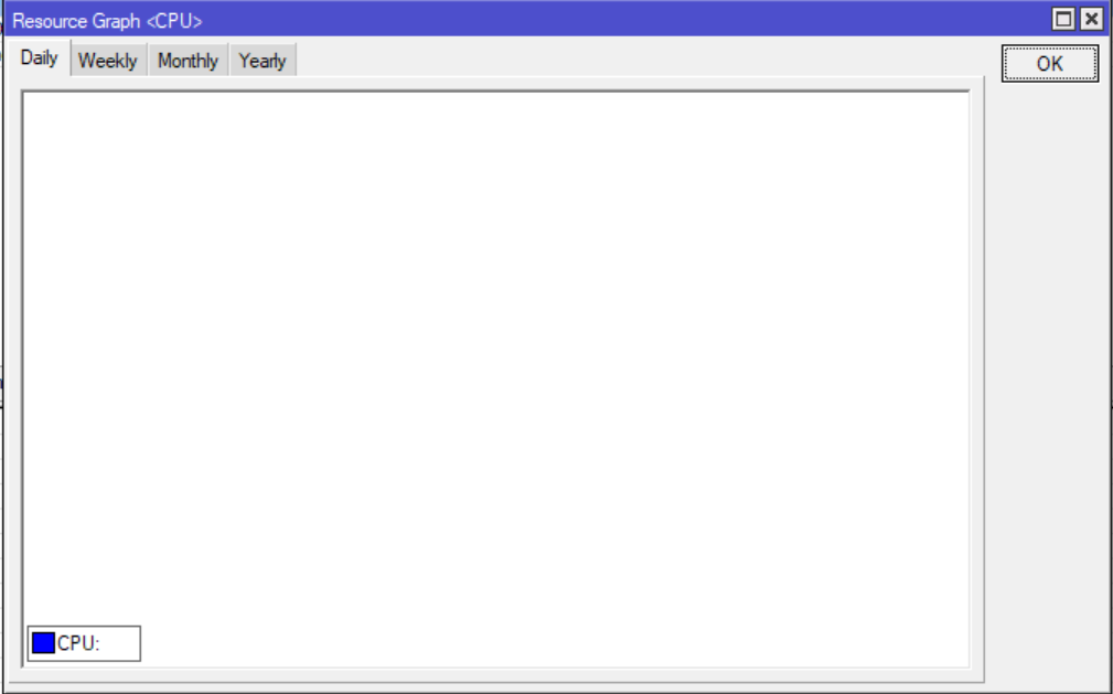

What is the best way for checking for a CPU spike - a graph?

You can enable graphics to the CPU, on the router itself.
tools → graphing
No the addresses provided from each ISP never change - they are in effects static
The graphs for CPU are empty - do I need to enable it somewhere?
Yes. In the Tools → Graphing section.
At the command line:
/tool graphing resource add
Will add CPU, memory and disk graphs. This will allow access to the graphs from any address. If you want to limit this, add the range of allowed addresses, or limit it in the firewall.

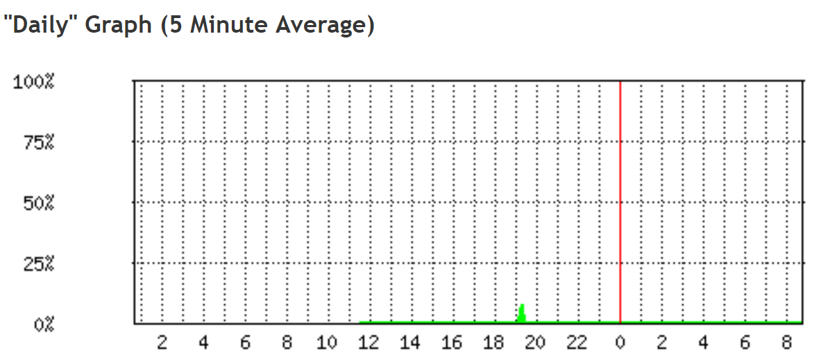

Here is the graph - nothing odd I think
