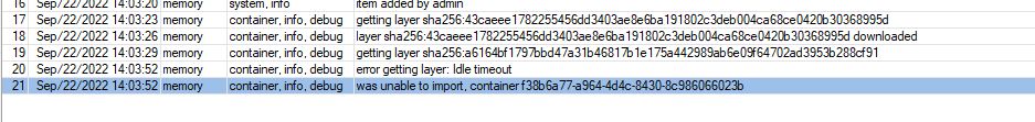

The logs during the pull of the image show this
I run RouterOS 7.5
Did you check the SD Card for bad memory blocks before trying to use it?
The SD is brand new, how ever i tried with another SD and got the same behaviour result.
Brand new?
You have formatted with RouterOS before using it, or you just put the SD and use it?
Formatted using ext4. that is the first thing i did.
Ok, is a info you must already provide.
