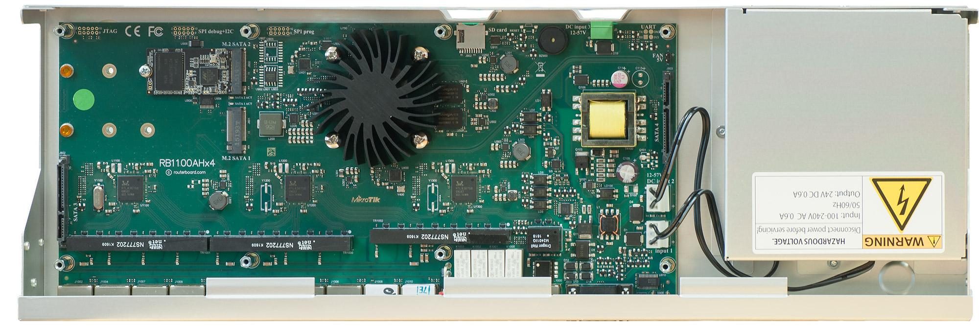

I cannot see the usual transformer/opto-isolater arrangement required for DC-DC isolation, but they could be hiding under the 2.5" mounting bracket…
There is no special grounding connector, but you can ground the unit at the PCB mounting screws inside the case.

Neither is connected to ground. The DC is isolated.
About what is hiding under the mount plates
Oh look, there they are! :slight_smile:

The RB1100AHx4 power design looks very similar to RB532a, RB600 and RB800.
