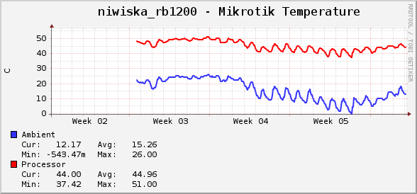

Just one other thing - what do you guyz think about this HEALTH monitor - are these values good for long-term running, or should I forcefully dissipate heat on my RB1200:
Voltage 12.2 V
Temperature 45 C
CPU Temperature 61 C
I think, you won’t be able to cool it down :wink:
