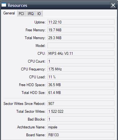

PS: below you can see the load of the second RB133 with the same cfg and the same number of clients connected

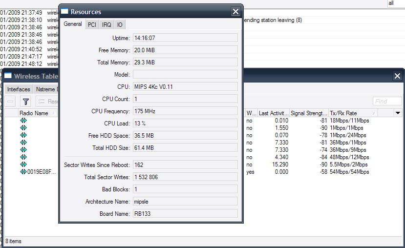

We’ve got the same problem while updating from 2.9.51 to 3.20 on 133C’s, disabling SNMP and bandwidth server made the CPU go down to normal load.
Thank you for your reply :slight_smile:
Ive noticed that removing the snmp made quite some improvements to me too, in fact, since i disabled it ( ± 14 hours ago ), the RB133 is working as should be as you can see on the img. below.
:smiley: let us see if this is “the final solution” :stuck_out_tongue:
