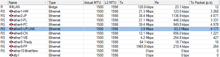

Hello.
Recently, we had to use an RB2011 as a Switch because one of ours got damaged by an electric discharge.
So, we decide to use the switch chip inside of it, and bridge the two master ports.
The configuration worked just fine, but we have notice an very asymmetrical traffic.
like this:
Is this normal ? How to avoid this?
I had disabled most packages, like: ipv6,hotspot,wireless,routing,mpls,dhcp …
Just to use switch chip.
Any help would be much appreciated.
Thanks.
Hard to see from this anything abnormal.
Is someone complaining?
Otherwise, maybe something more go damaged due to the discharge.
Check the uplink traffic.
It should be the aggregate traffic from those others interfaces.
