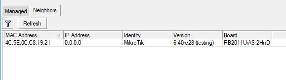

During the brief connection, I can see the MAC address is 00:00:00:00:00, IP 0.0.0.0, the full quick config is missing, and I don’t have time to reset the config

Have you tried MACWinbox? Click on the “Neighbors” tab of Winbox, then “Refresh” if the list is empty and see if your RB2011 shows up. You probably know this but for MACWinbox discovery to work, your PC has to be physicaly pluged to the RB2011.
If you still have problem, go the RS-232 (console) way. You can’t get kicked out of that!

Yes, I have Ethernet into Ether2 or Ether1, does not seem to have the fire wall running, so either one works the same.
