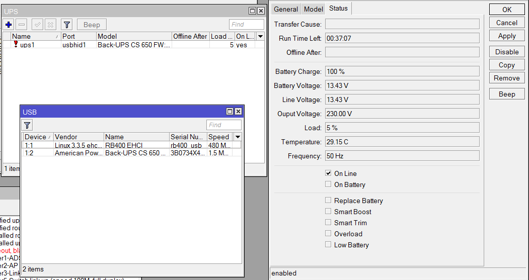

I use on all my places APC ups and Mikrotik UPS package to monitoring.
Usually it is APC CS 650 connected to USB port on 750UP, 411U or 433GL on some places use APC Smart UPS 750 but connected to USB to serial converter because not have serial port on that location and directly connected ups on USB port not give all information of status compared to serial port.
But using serial to USB converter and ups package in Mikrotik have one bug if you reset routerboard or lost power ups by itself remove need to add again always happens when is used usb to serial converter.
