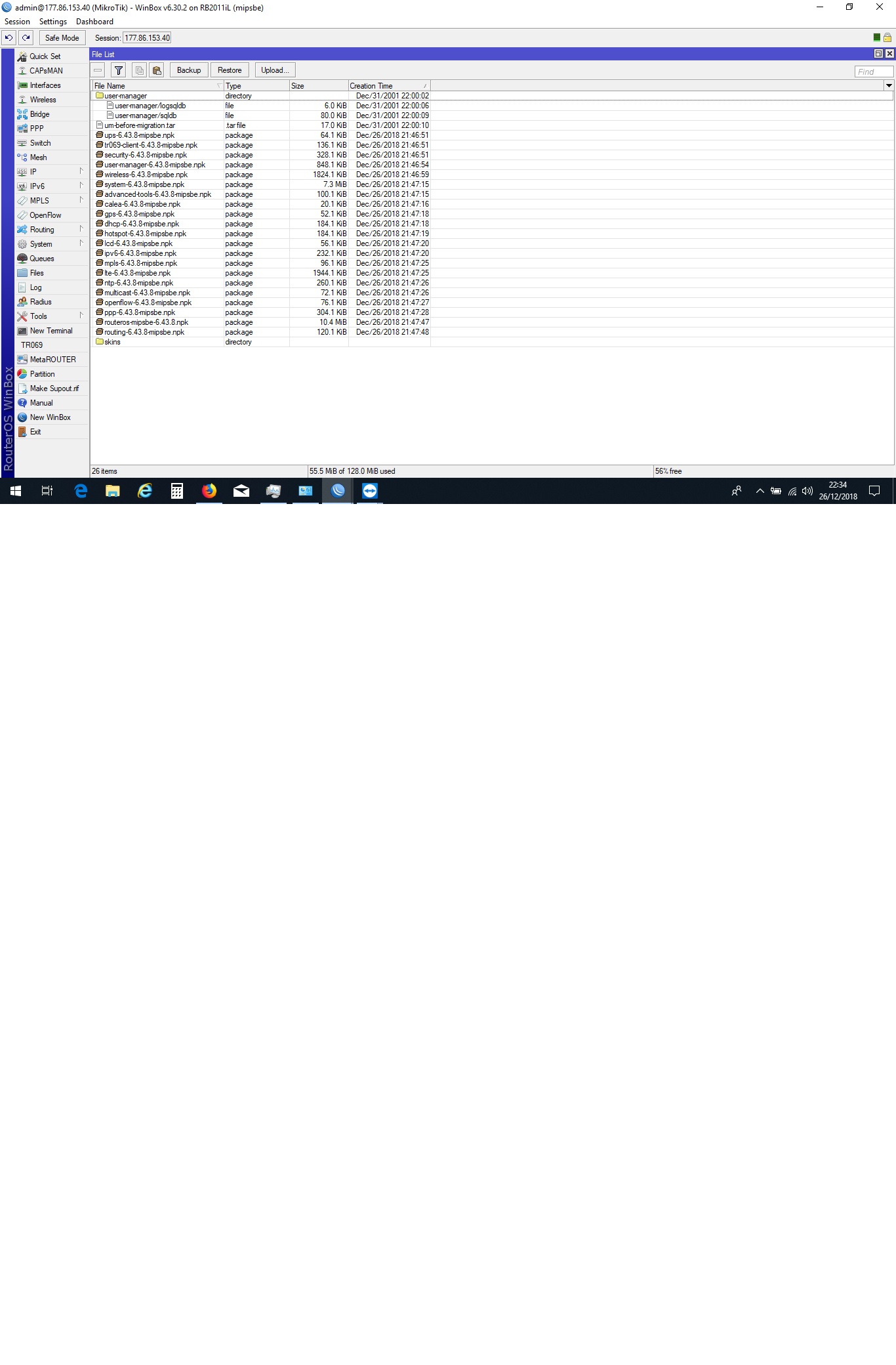

  7. SUDDENLY some files appears in "FILE " and a line in SYSTEM>>SCHEDULER too.
    PANIC !!! I’ve deleted the files and the line too… (maybe a stupid reaction)

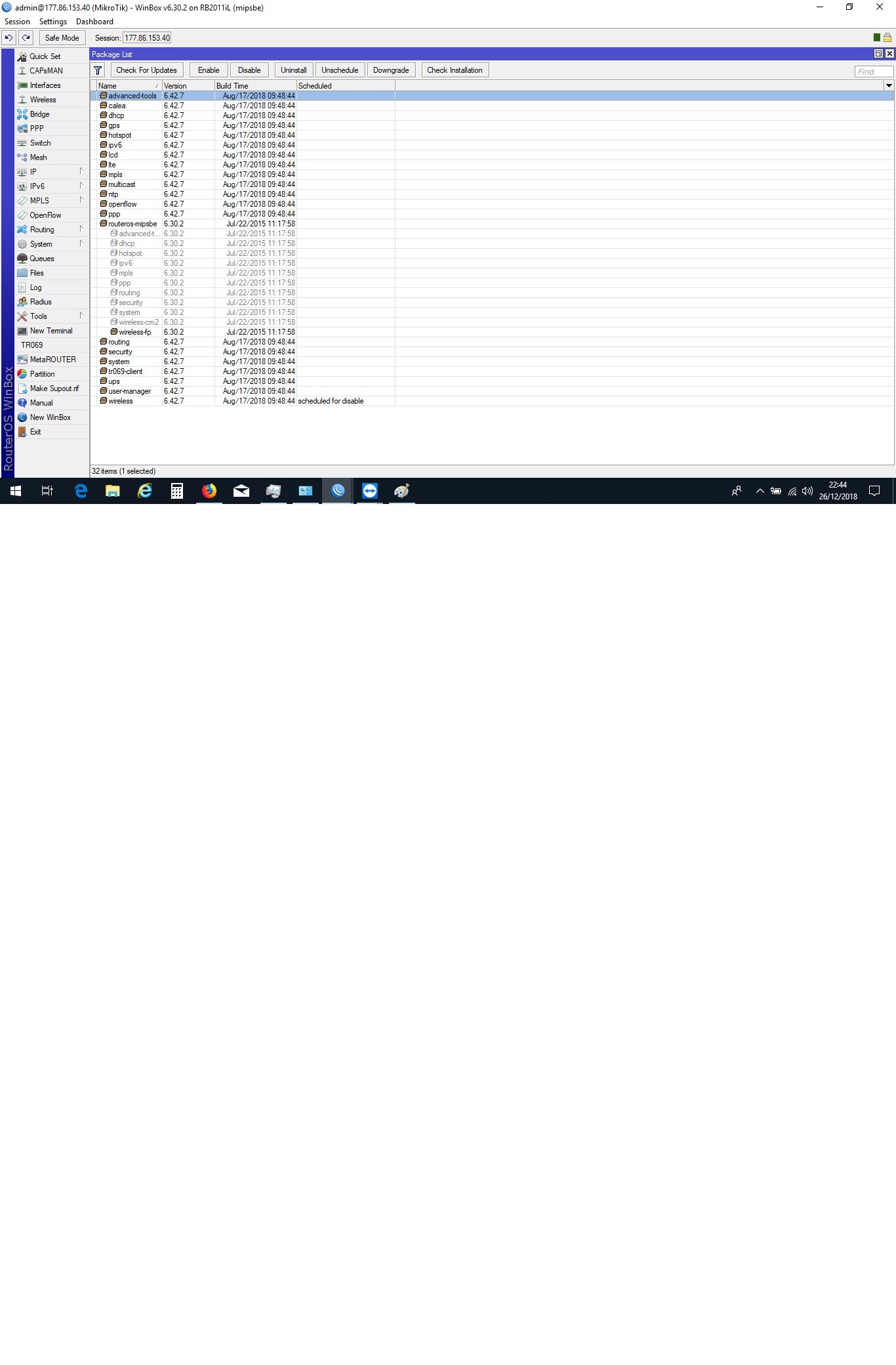

After some reboot… for my surprise, the ROS seem to be downgraded to 6.30.2.
Transfer newes upgrade files and reboot… no way.
Now i 've this incredible situation:
In "file i have 6.43.8 .npk files (downloades using “check upgrade”)
in the SYSTEM>>PACKAGES i’have a strange mix of different pakages

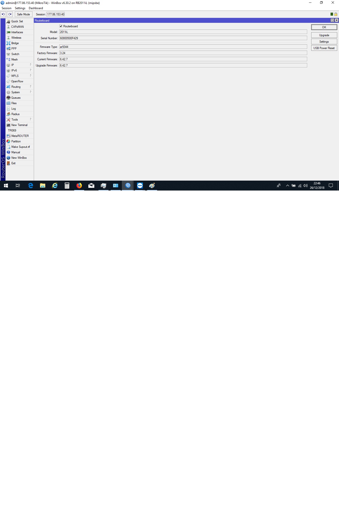

And in the SYSTEM>>ROUTERBOARD the following…
Someone may help me to take a direction ? Net install option is not available.
