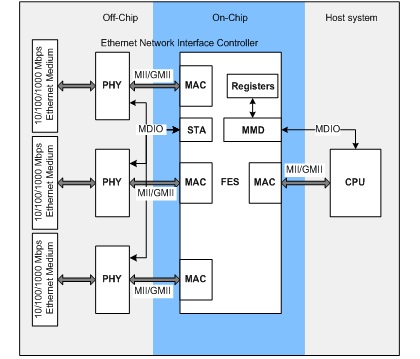

One interesting point is that both the 951G & 2011 use the same switch chip for the gig ports (Atheros 8327)
Kind Regards
Mark
The switch chip and the PHY are two different parts. the PHY is the physical interface that does the actual connection
