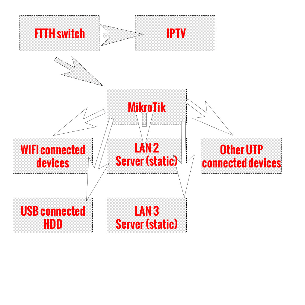

just got a hold of RB2011UAS-2HnD-IN and well I have a couple of questions. Starting off I’ve connected the MikroTik from my FTTH switch to ETH1 (since to be honest I simply cannot remember where I put my “UTP” GBIC, so that I could use the SPF port). So now the problem is as follows; I would like to use the local-bridge mode for all devices (even the ones on wifi) connected to the MikroTik, but I would also like to see some of the ports to be “fully bridged” since there will be some servers connected to it, they need an external static IP address configuration. The others non bridged and wifi ports would also get a shared static IP address since now even thou I choose static IP in the quick options, the static IP does not get shared over to the users, instead it shares a random DHCP IP that it gets from my provider.
I’ve included as small picture of the setup. Any tips are appreciated.
Hiun
It seems to me that you are using almost the default setup and the nating in to the servers there is an excellent guide at Gregs Sowells site http://gregsowell.com/?page_id=951 that can help you a lot in this
