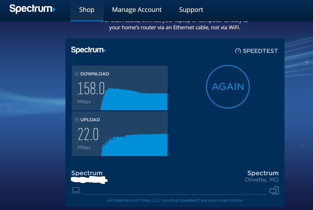

Then I noticed that even with Fasttrack enabled, I was only getting between 150-200mbps max download with the exact same config as before with only about 5% CPU at idle, 30~% under load with fasttrack enabled. I even install a previous backup from a time when I know i was getting full speed just to see if I messed something up, but the speed issue remained. When I connect directly to my modem from my computer, I get about 440/22, so I know the issue is not on my ISP’s side. I even tried to move all other wired connections to the other switch (the 100mbps ports) to rule out any interference from other ports on the same switch.
The internet speed also seems to be inconsistent when running through the 2011 through fasttrack: it sometimes starts out around 250-280mbps, then slows to 150-200 when using speedtest.net. Sometimes it starts at 150mbps and goes down to about 110mbps. With fasttrack disabled, i get about 73mbps down with 80% CPU usage.

I tried disabling the hardware offload that my computer is connected to and still get the same result. I disabled Unicast Flood, Multicast Flood, Broadcast Flood and still the same. Now, the speed test starts at my max download (400mbps) for a brief second and then quickly ramps down to 200mbps for the rest of the test. (attached

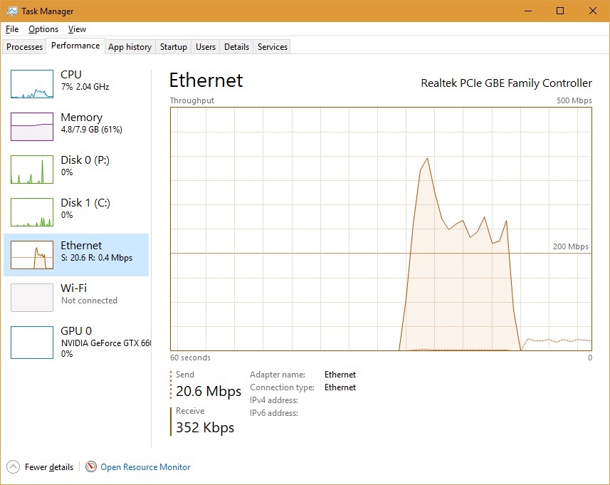

CPU maxed at ~40% during 400mbps internet speed test download, then dropped back down to ~25% for the rest of the 200mbps average. When transferring files on local LAN at gigabit speed, CPU goes up to ~65% for 950mbps speed going from a hardware offloaded port to non hardware offloaded. On hardware offloaded port to hardware offloaded port on the same gigabit switch series, cpu doesn’t go above 6% for same gigabit speed transfer, so hardware itself seems to be working fine.
Any idea on what settings might be causing the drop in speed after the initial good speed?

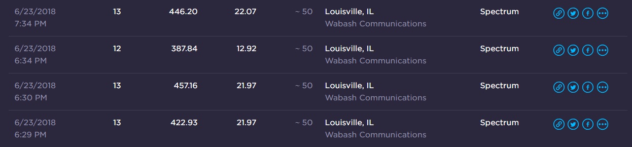

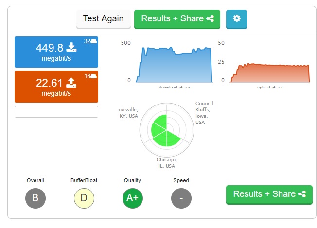

I went to dslreports.com and performed a speedtest and got a full 450mbps or so speed test :confused: .
I understand how queues can impact tcp single connection performance, but I had fasttrack enabled and got the same results. I also reset the router to vanilla WISP AP and also Home AP and only had laptop and modem connected to the router with no queues or mangle rules and still only got 200mbps. Any ideas on how to improve TCP single connection performance?

These are both screenshots for speedtests i get with this configuration. CPU doesn’t exceed 45% with the faster result speedtest. Slower speedtest cpu doesn’t exceed 26%.

Thanks CZfan, I fixed the code view. CPU never exceeds 45% or so when running at that 450mbps speed and my connection is going through fasttrack. Both of those screenshots were different bandwidth tests with that same configuration that I’ve been running for 2 years. One of the connection tests runs through multiple TCP connections is what mikrotik support was telling me, the other is only a single TCP stream. I used to get these speeds normally from speedtest.com when i first moved to this house in june, using that same configuration with fasttrack, but now i’m not. The only thing that changed is i updated my firmware and routerOS to current.
