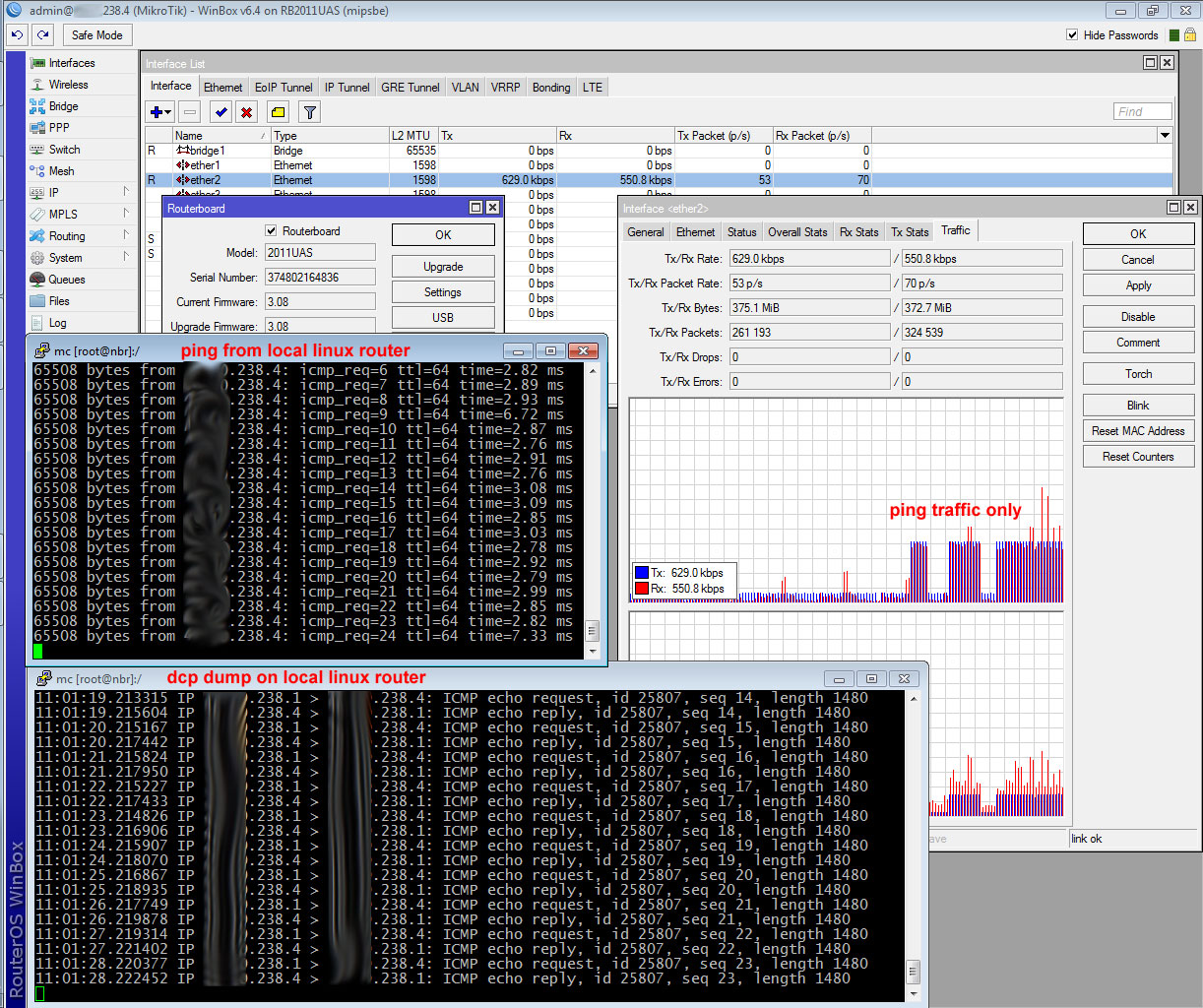

First test (first image):
RB2011UAS — Giga switch — Linux router
All test was OK ping from Linux to RB on 65500bytes is 2,7-3,0ms and 0% loss

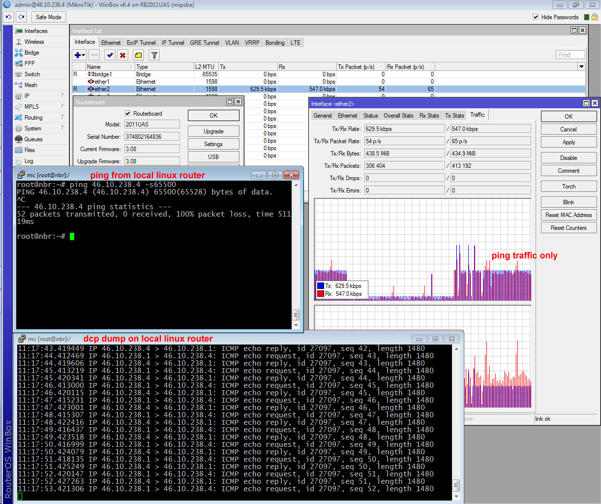

Second test (second image):
RB2011UAS --100M-8port switch – Giga switch — Linux router
Same ping was 100%loss

Strange in the whole situation is that the graph shows two-way traffic on RB2011 port and replays on Linux tcpdump, but there are 100% losses!

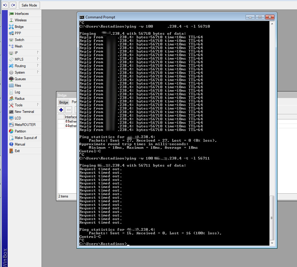

My laptop (100M) — RB2011UAS local ping tests:
Pings whit 56710bytes is OK , but whit 56711bytes are 100%
Board is factory reset and set bridge whit IP
