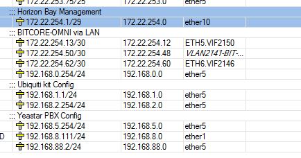

Ether1 : DHCP client 192.168.8.111–> LTE Router . 192.168.8.1 - Tried pinging it from the RB, timeout. Tried selecting the Interface, no difference. Checked the ARP table, the entry is present. Attached a screenshot. Further to this if I connect my laptop directly to the LTE router, I immediately get an IP address and am able to ping the unit.

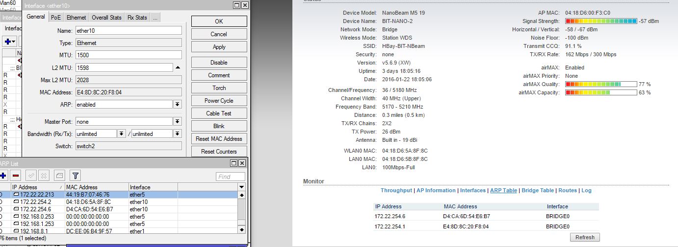

Ether10 : POE with IP address 172.22.254.1/29 → Ubiquiti Nanobeam 172.22.254.2 - I can ping this but it is going via another path in our wireless network. I’ve attached the ARP screenshots and can see by the 3-4ms latency that it is not going direct to the Nanobeam.
If I put the Nanobeam into a POE injector and connect my laptop directly, then I can ping it with 0ms. Also checked the firewall, nothing in our filter rules about 172.22.254.2, accept it being on a “accept DNS” address list.
