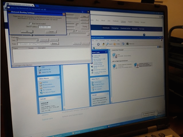

I made some gif animation with the state of router and netinstall software.

Sorry but GIFs doesn’t provide enough detail to troubleshoot.
In fact the first one leads to believe a successfull netinstall was done.
Good idea anyway :slight_smile:
Try powering off the rb2011, press reset, and while keeping reset pressed, power it on until without releasing reset until you see it on the netinstall list of devices.
Tip: connect it directly to the netinstall computer, and disable any other network interfaces but ethernet (wireless, etc) on that computer.
