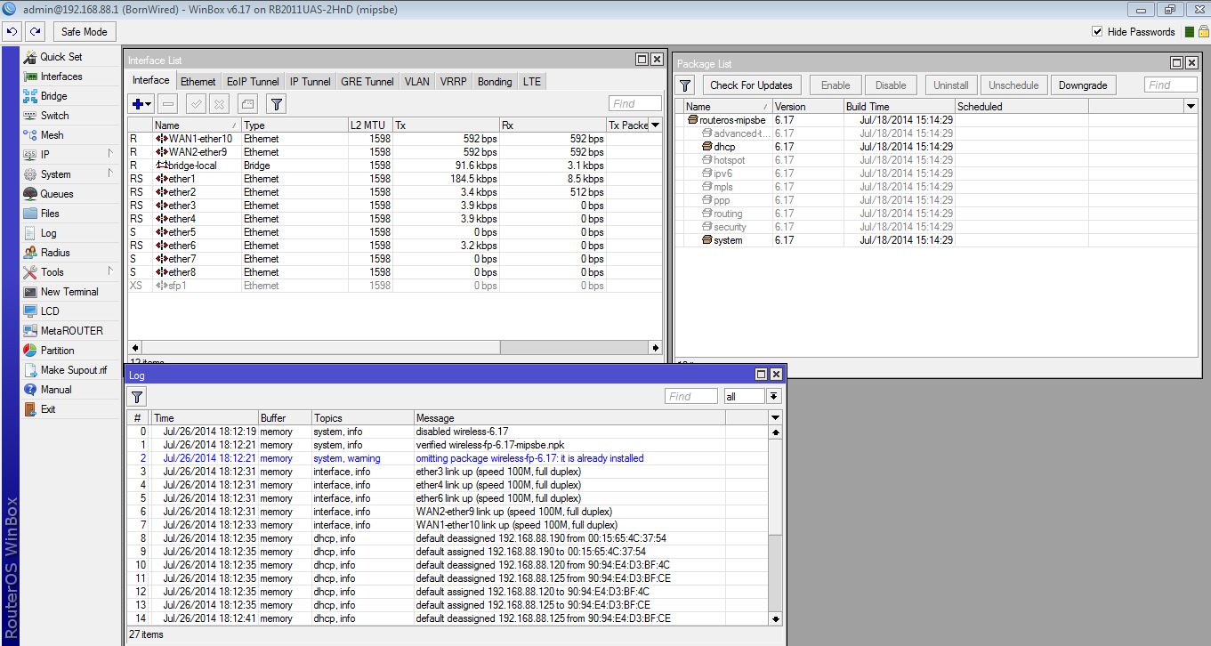

Can you post a screenshot of your packages ?
And manually upload only the wireless package and see if it will install ?
Tried resetting the device and re-installing the entire mipsbe package - problem persists.
Tried to manually install the standalone “wireless” package - problem persists.
Tried to manually install the standalone “wireless-fp” package - problem persists.
Wireless is not displayed in the “interface” list.
Wireless package is not visible in the “package” list.
And the same error appears in the “log”.
Screenshot attached.

Tried reset and netinstall using 6.17 package but the problem persists.
Just downloaded 6.15 package, will try this instead and see if the problem gets resolved.
Okay now, everything is up and running again.
