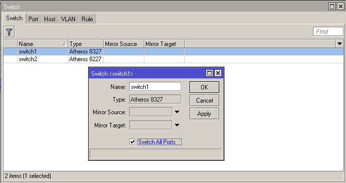

this is the first time I’m using an RB2011L. I’ve noticed that there are in Ethernet interface detail two “switch”: 0 and 1.
How do they work? Are they different switches? Does hosts on switch 1 can communicate with switch 0?
Thanks!

if both switchgroups are bridged then yes, they can communicate with each other.
Thanks for your answer.
Do I need to set both of two switches on this “Switch all ports” in order to do what you’re suggested?
Please read this manual, how to use switch chip features.
http://wiki.mikrotik.com/wiki/Switch_Chip_Features
