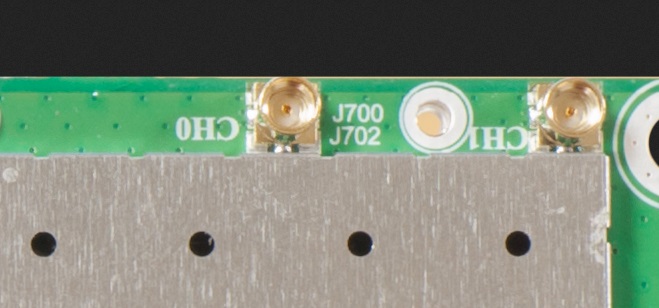

Yes, the device has MMCX connectors for the built-in antennas. If you open the top cover, unplug the original antennas, you can then plug some other antenna in their place.

When opening the RB2011UAS-2HnD-IN and removing one antenna as you indicate, is the plug in the router an MMCX male or female ?
Female

RB2011UAS-2HnD-IN + D-Link ANT24-1202 doesnt work! :frowning: Antenna was pluged into chain0. No signal increase. Cabel length ~2m. Tried to put off chain1, regulate TX power, Antenna gain - no results. Old D-link router worked with this antenna fine. Now, distance ~30meters -80dBm. Whats wrong?
