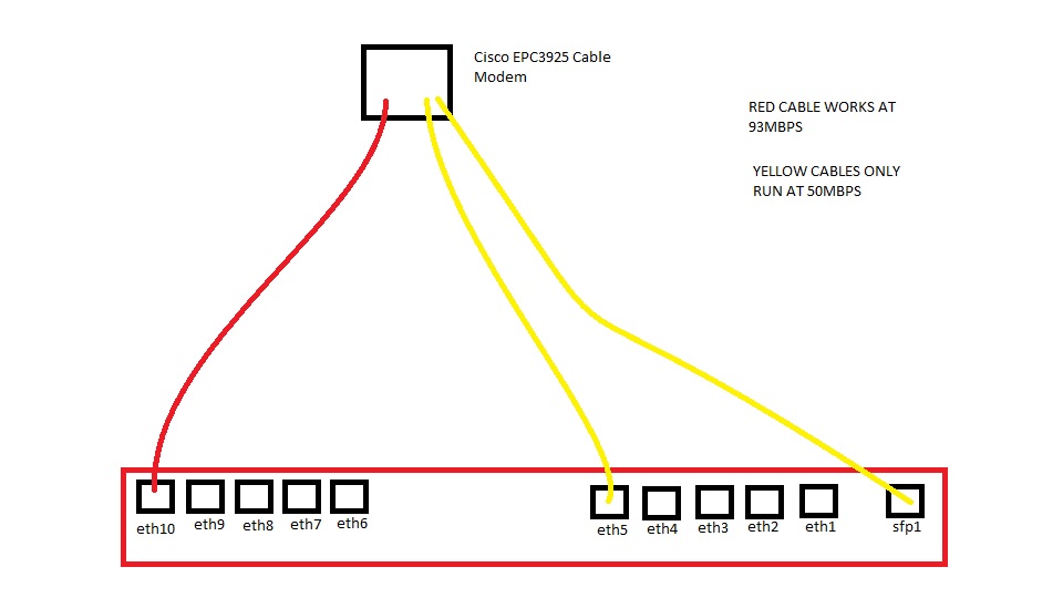

Having an issue with my RB2011UAS-2HnD-IN and the gigabit switchports.
Running cable internet that works at 100Mbit, with my Netgear WNDR3700 i can speedtest at 116Mbps
If i plug the modem into the 100Mbit switch ports on the device i can get a speed test of 90 - 95Mbps (Expected)
If i plug the modem into the 1000Mbit switch, speedtest is restricted to approx 50Mbps.
Have tried doing this on a basic configuration with only Masquerade NAT Rule and DHCP Client configured to test and the same results happen.
Basic diagram attached - Appologies Visio is currently not installed
Any Ideas why the Gigabit ports are not running at the full 116Mbit?

you set differents bridge for port1 and port5 ?
if not its possible you get a loop !!! or maybe not if u configured dhcp-client. this modem have 4 port for LAN switch, not 4 wan port…

The modem does indeed have 4 WAN ports if you place it in Bridge mode,
