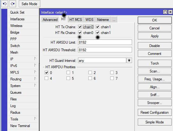

You have by wireless interface at “HT” all the chains selected?
See printscreen
Yes that is what I have selected !
