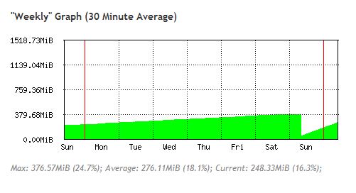

Hello
Same problem with route-cache on RB1100AHx2.
ROS v.6.15, fw 6.10
Attaching memory usage graph, when it becomes up to about 400MB router stops respond to IPv4 and can be accessed only by MAC telnet.
Router is actively using for site-to-site and l2tp VPNs.
