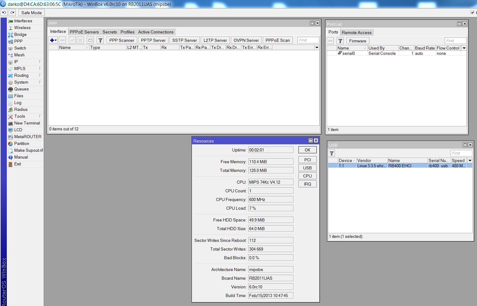

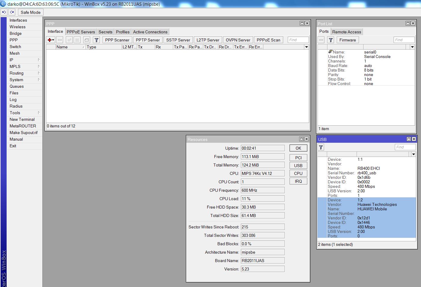

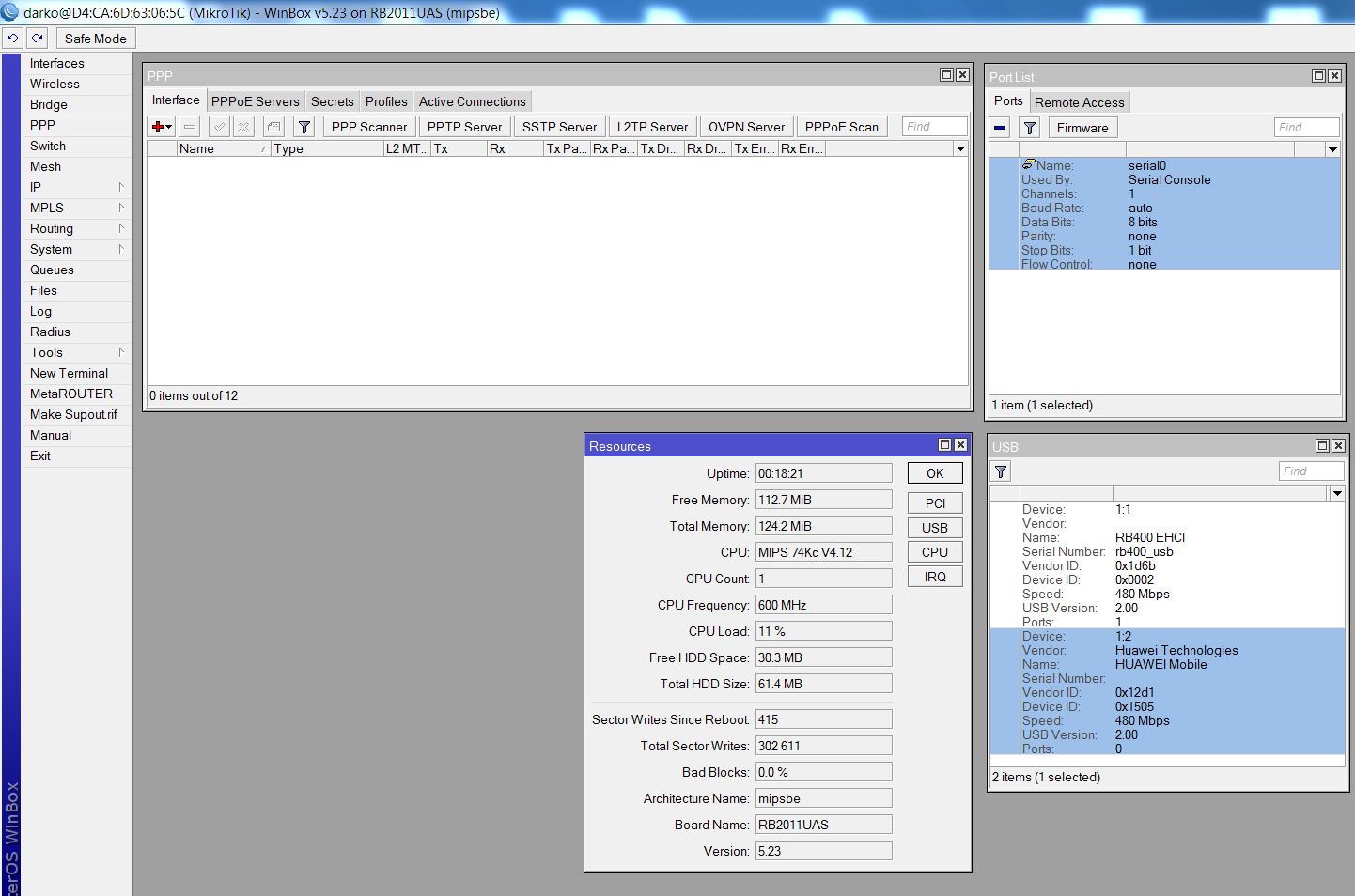

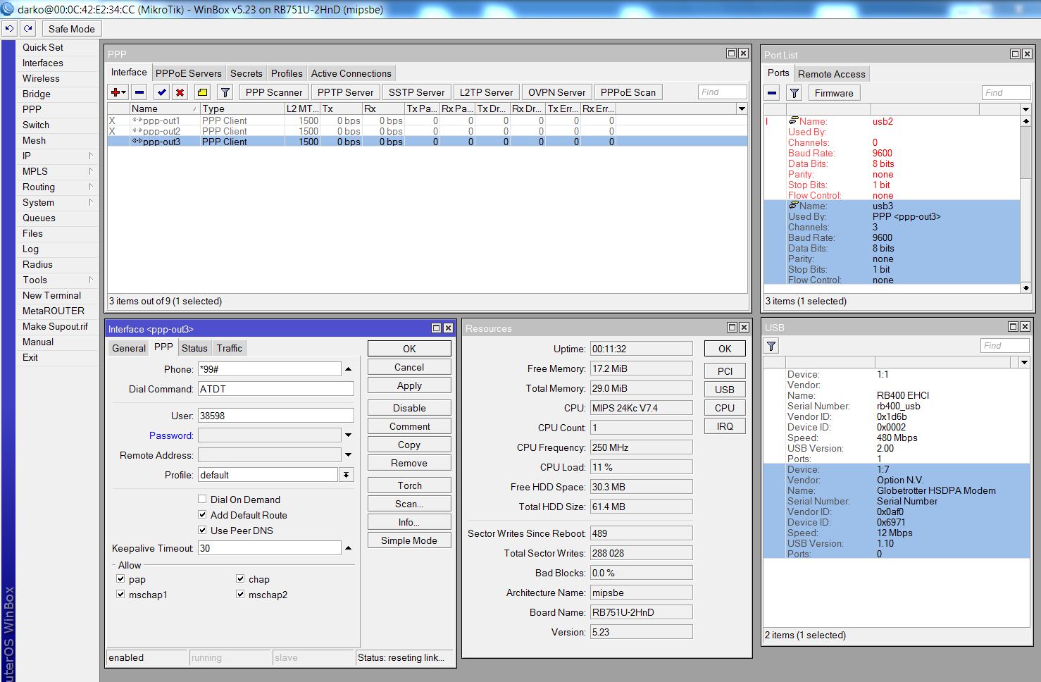

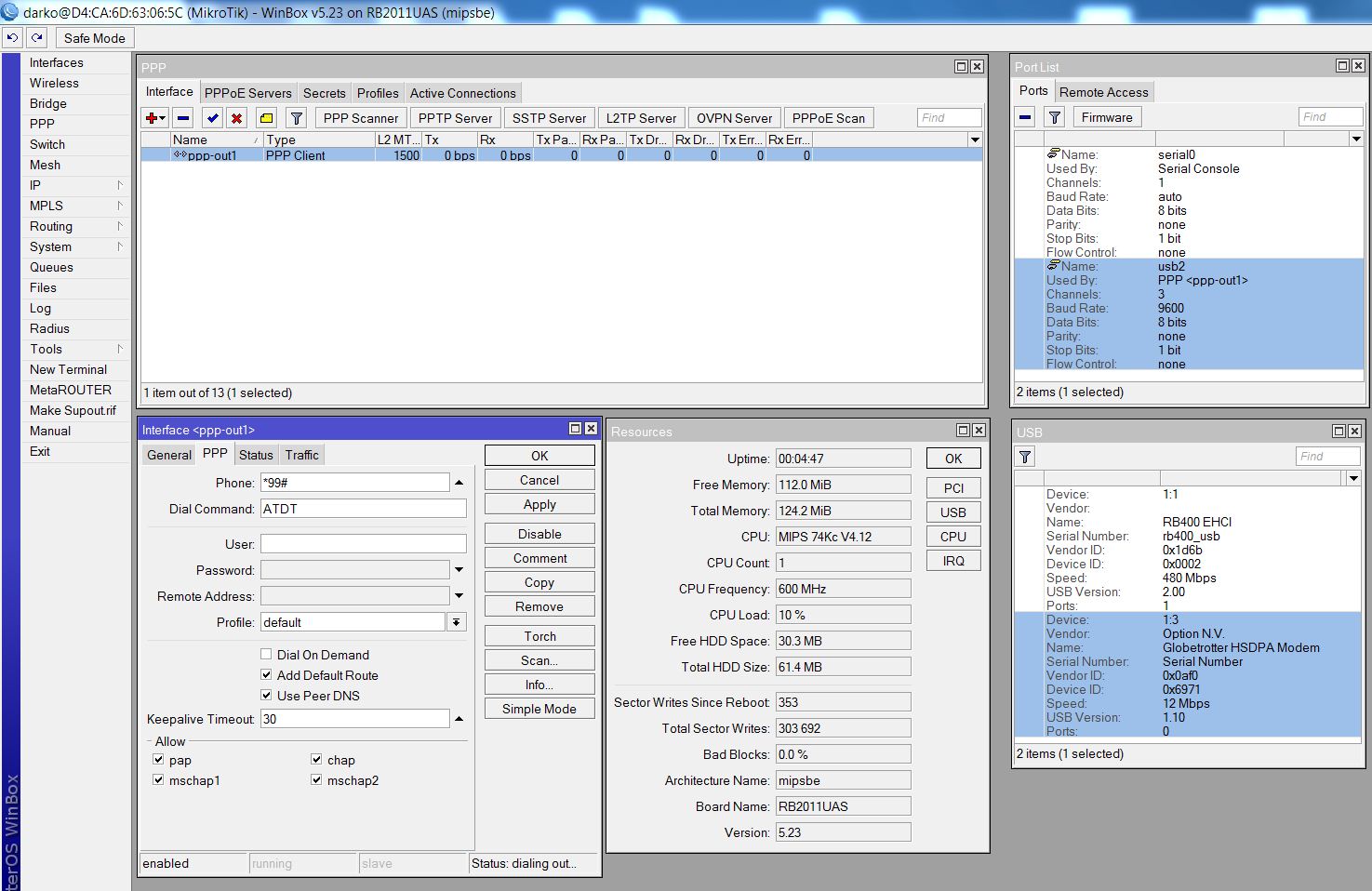

Here I create some test and RB2011doues not recognise HUAWEI modems.
I attached 6 pictures and for RB751U abd RB2011UAS-RM with E372, E392u and an old OptiondNV modem tests
As you can see os is 5.23 for both RB…
I do NOT beleive that is OTG cable is problem because modem are recognised as and USB recsource, but neither USB port and ppp_out clinet is not created for HUAWEI modem, but for OptionNV everything is OK.
Unfortunatelly I can not test Option for connection because I do not have DATA SIM card, but Option is installed fully on both RB (751U and RB2011UAS)

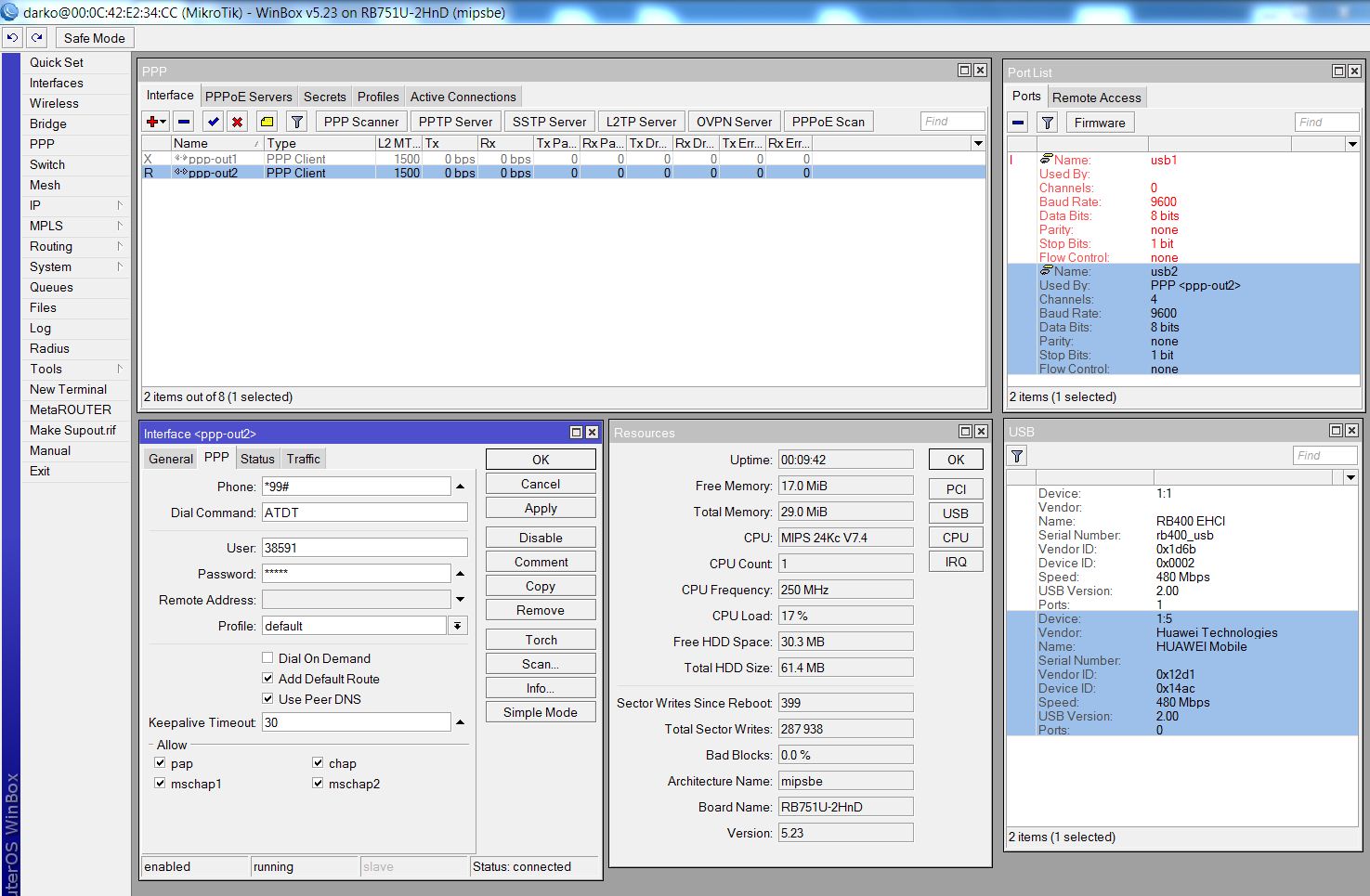

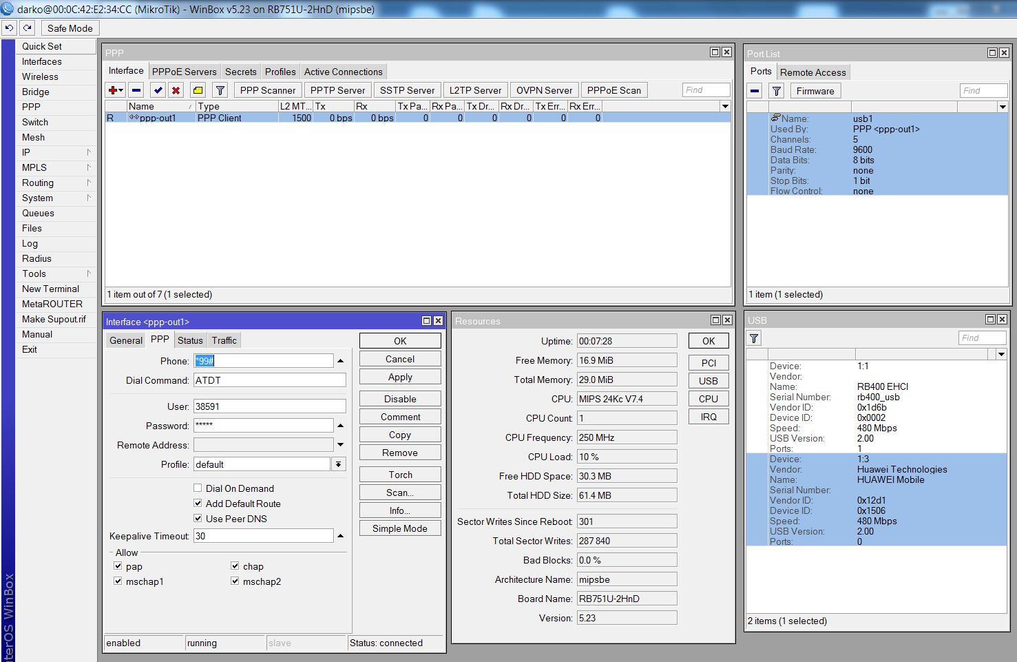

Here is Pictures for RB751U
Here pict for RB2011UAS-RM
As you can see same HUAWEI modems not recognised correctly… (there no USB Ports and PPP_Out Clients)

See picture attached - in ROS6rc10 there is none of my modems recognised!

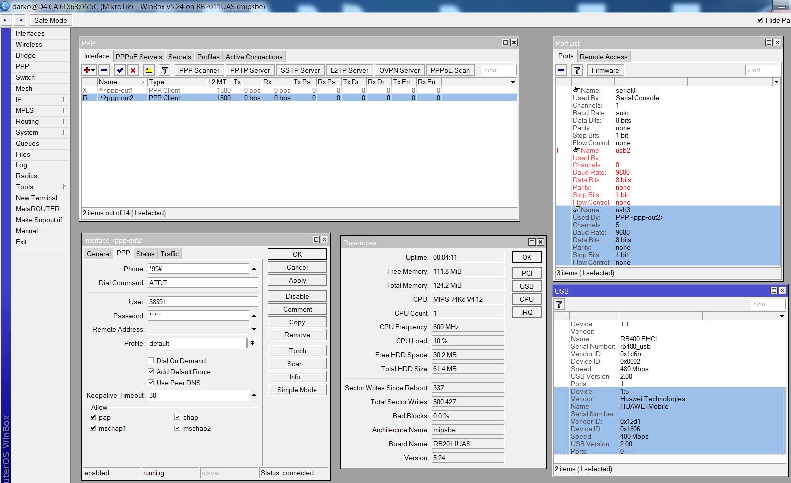

I downgrade ruter back to 5.23 and today I make upgrade to 5.24…
In first it did not work as usual, but, then I do what you suggest…
  1. Shutdown router (RB2011UAS-RM).
  2. Unplug USB Modem from and OTG cable (MicroUSB->USBFemale)
  3. Unplug router (RB2011UAS-RM) from power source
  4. Plugin router (RB2011UAS-RM) to power back again and wait reboot
  5. Login and plugin USB Modem to OTG Cable…
AND IT IS MAGIC - Now router correctly recognise HUAWEI USB modems!!!
