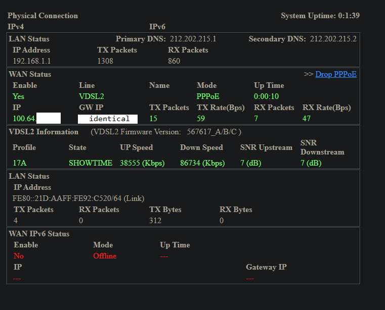

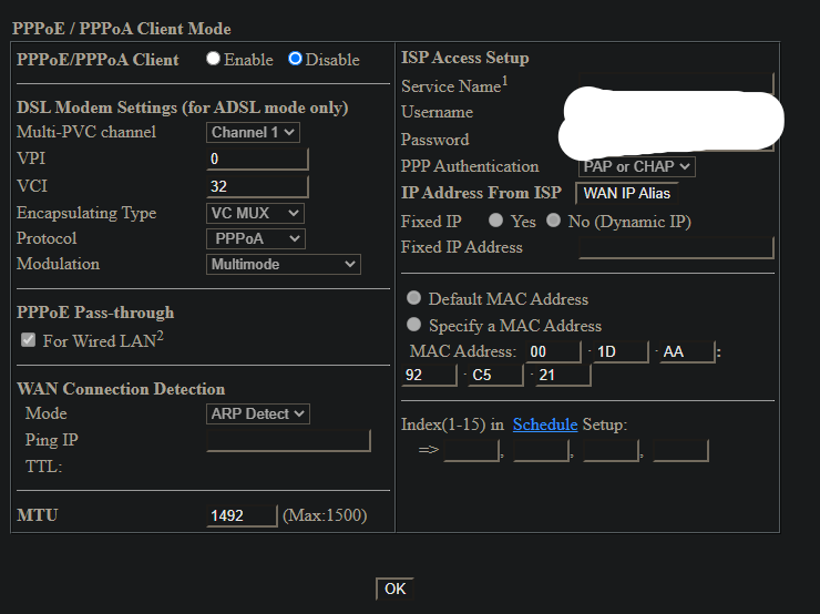

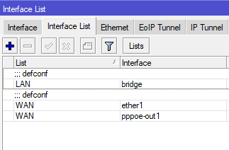

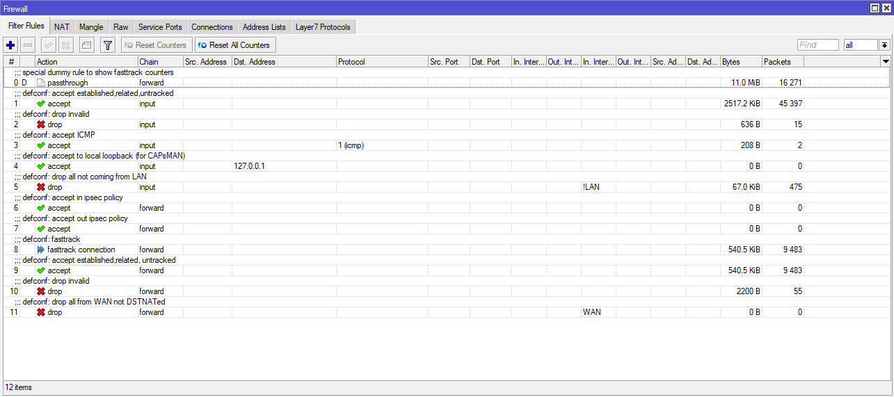

I have used a RB951Ui-2nD in combination with a Draytek Vigor 130 successfully for almost two years now. After a rather unfortunate accident I had to replace my former Mikrotik hardware. Therefore I ordered a RB2011UiAS-2HnD and after receiving it today tried to install it. So far I was unsuccessful. In general I tried set up the Vigor 130 in bridge mode and configured the Routerboard to use a PPPoE client while keeping the device at almost factory settings - other than different WLAN and administrator passwords and the default firewall rules. Unfortunately I don’t get any successful internet connection. Testing the Vigor 130 directly in PPPoE-mode showed that a ping to servers is possible which leads me to believe that my PPPoE credentials are correct. It also seems like the router is successfully translating local IPs and forwarding packets to external IPs, but their replies never reach the RB for some reason
I have attached logs and screenshots which might be useful for a diagnosis, but I am clueless at this point.
Thank you very much in advance.

What does /ip dhcp-client print detail show?

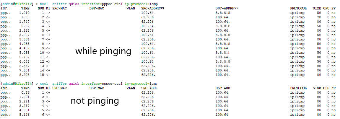

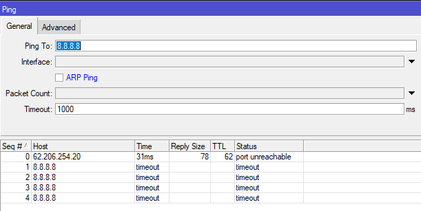

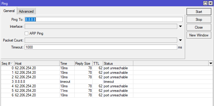

From the ping window it seems to me that the pings are actually blocked in the ISP network and the ICMP notifications about that do arrive to your device.

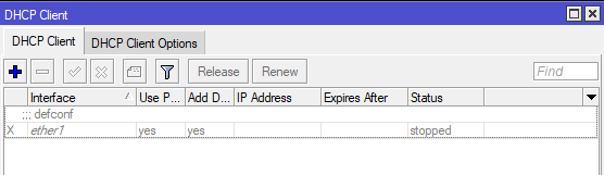

So I assume that since you haven’t disabled the /ip dhcp client associated to the uplink port, the ether1 on the 2011 has got an address and route also via DHCP, and is sending traffic from the DHCP-assigned address via the DHCP-assigned route rather than using the PPPoE-assigned ones. So disable the DHCP client (no need to reboot, the address and gateway will disappear once you disable it) and try again.
If that doesn’t help, run /tool sniffer quick interface=pppoe-out1 protocol=icmp in a terminal window, ping 8.8.8.8 again, and show the result of the sniff.
Hello sindy and thank you for your reply.
I have now disabled the DHCP client for the uplink port. Unfortunately that didn’t help so far. All ping request from the Routerboard still return “port unreachable” or “timeout”. There is no HTTPS connection possible from clients behind the Mikrotik router.
Please note that I have changed the port 1:1 to ether2 at the moment so the screenshots above are a bit outdated. Other than that I did not change anything.

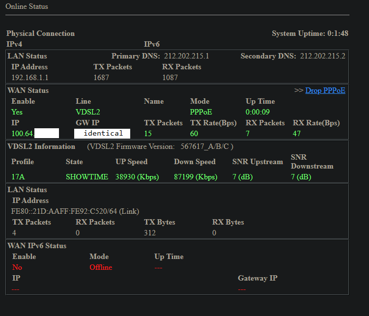

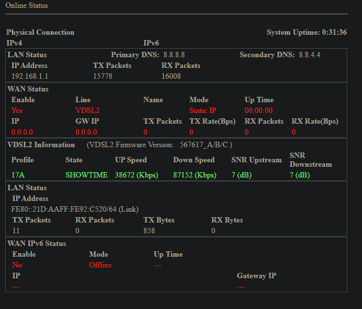

It’s really weird, as the PPPoE interface is obviously (augensichtlich) up and both sending and receiving, but the traffic is not passing through further in the ISP network. The ICMP “port unreachable” messages shown as responses to the ping are most likely not related to the ping and shown by mistake (ICMP echo has no notion of ports) and as your sniff from the time you don’t ping shows some ICMP packets to come from the same IP address too, I assume they are sent in response to some normal traffic (non-ICMP) which tries to get through.
So it all looks like an issue at the ISP side, but since it works when the PPPoE client is up on the Vigor, that issue must be somehow related to the identity of the 2011.

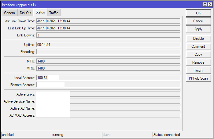

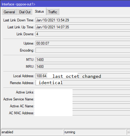

So a question - do you get the same WAN IP via PPPoE at each disabling and re-enabling the PPPoE client interface, say, 20 minutes later? Btw, 100.64.0.0/10 are not public IPs, they are “carrier grade NAT” addresses whose role is not to overlap with any RFC1918 private range nor with any public IP, so the ISP doesn’t have to deal with conflicts with LAN subnets no matter what ones the subscriber chooses to use.
Another question, are you perhaps able to remember (or even retrieve) the MAC address the RB951Ui-2nD was using on its WAN interface, and try to set that MAC address on the 2011’s ether1?

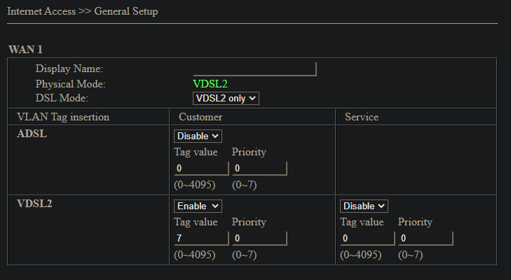

Yet another one, could it be that some VLAN must be set for the PPPoE?
I see thanks for the information regarding carrier NAT adresses. I am sometimes rather careful when it comes to publishing IP adresses on the internet :slight_smile:
The results of this test are the following:
  • The local 100.64.0.0/10 ip changed with every re-connect. Usually just the last octet.
  • The remote WAN IP was identical each time - even switching between the 2011 and the Vigor 130.

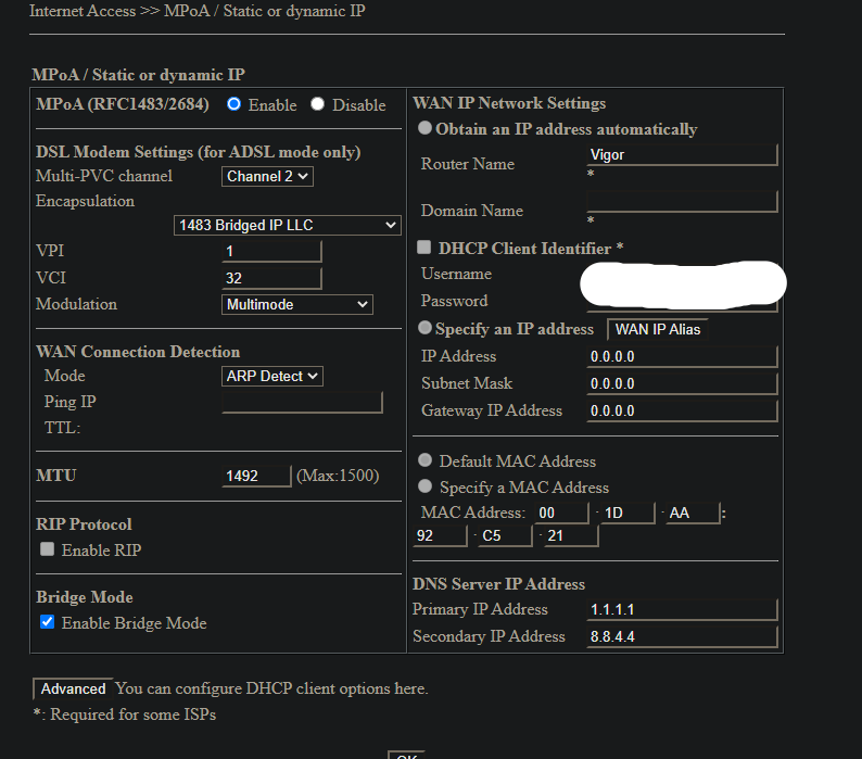

Yes I still have the sticker with all information like ETH1, WLAN MAC addresses and the SN of the RB951Ui-2nD and changed the MAC address of the ether1 of the 2011. Unfortunately nothing happened here as well.
You are correct. Deutsche Telekom / T-Online requires a VLAN 7 tag, which I have enabled in the Vigor 130 which should untag it on the LAN port going to the 2011. This worked in the past with the RB951Ui-2nD.
OK, since the tagging and untagging is done in the Draytek, that’s also not the explanation.

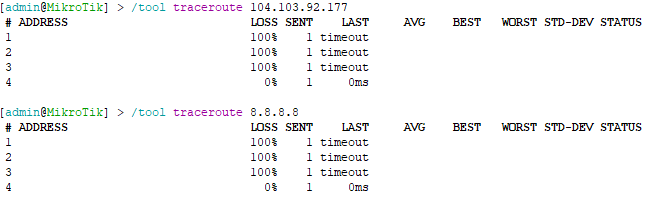

traceroute does not look very good:
[admin@MikroTik] >> /tool traceroute 8.8.8.8
 # ADDRESS                          LOSS SENT    LAST     AVG    BEST   WORST STD-DEV STATUS
 1 WAN.ip                    0%    7  10.5ms    31.7    10.1    76.4    25.9
 2 62.206.254.17                      0%    7  30.5ms    15.3    10.1    30.5       7
 3                                  100%    7 timeout
 4 62.206.254.20                    66..    7  22.4ms    20.9    19.4    22.4     1.5
 5                                  100%    1 timeout
 6 62.206.254.20                      0%    1  17.1ms    17.1    17.1    17.1       0
[admin@MikroTik] > /tool traceroute 104.103.92.177
 1 WAN.ip                    0%    5  13.8ms    16.8    11.3    23.5     4.2
 2 62.206.254.17                      0%    5  18.8ms    18.3    12.8    20.8     2.9
 3                                  100%    5 timeout
 4 62.206.254.20                     50%    5  30.7ms    32.4    30.7      34     1.7
 5                                  100%    2 timeout
 6                                  100%    2 timeout
 7 62.206.254.20                     50%    2  18.7ms    18.7    18.7    18.7       0
