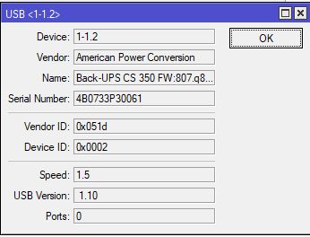

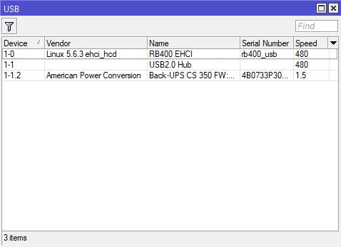

I was able to fix the problem by connecting the UPS through an USB hub.
It seems the problem is that the UPS is USB1.1. (I had the same problem with my USB1.1 weather station connecting to meteohub)

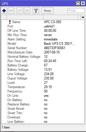

Now all seems to work but I have one additional question - why is there an exclamation mark on the UPS?
