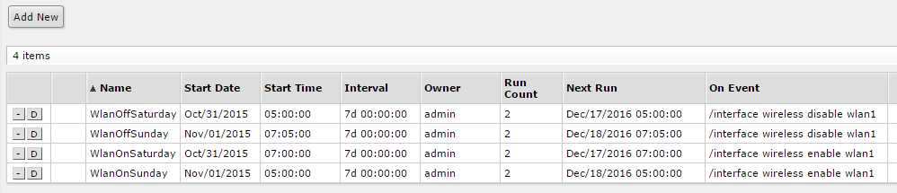

I got a odd thing going on in my Router, every Saturday night my router becomes something called CAP, how is this possible?
so every Sunday morning i have to log in and change it to Home AP again, and then it works as it should
Check in your scheduler & scripts to make sure there is nothing set to do this weekly.
The only script och Scema that i have is this, and it have nothing to do with CAP?
Does no one have any suggestion how ti fix this, every sunday morning i have t log in and set the router to Home Ap again
If you don’t provide any further information, you won’t get many replies.
Decribe the exact problem you are experiencing. Try to reproduce the problem by (e.g.) executing the scheduled commands manually.
Make exports from both situations (CAP and Home AP) and compare them with a text compare application (e.g., fc, windiff, diff, beyond compare).
Post relevant parts of your configuration export, not screenshots from webfig.
Furthermore: if it’s just the quickset combobox setting that changes and you don’t experience other problems, leave it there. Just don’t use quickset after initial setup.
Now it works, i deleted the wireless on and off schema and now it works.
