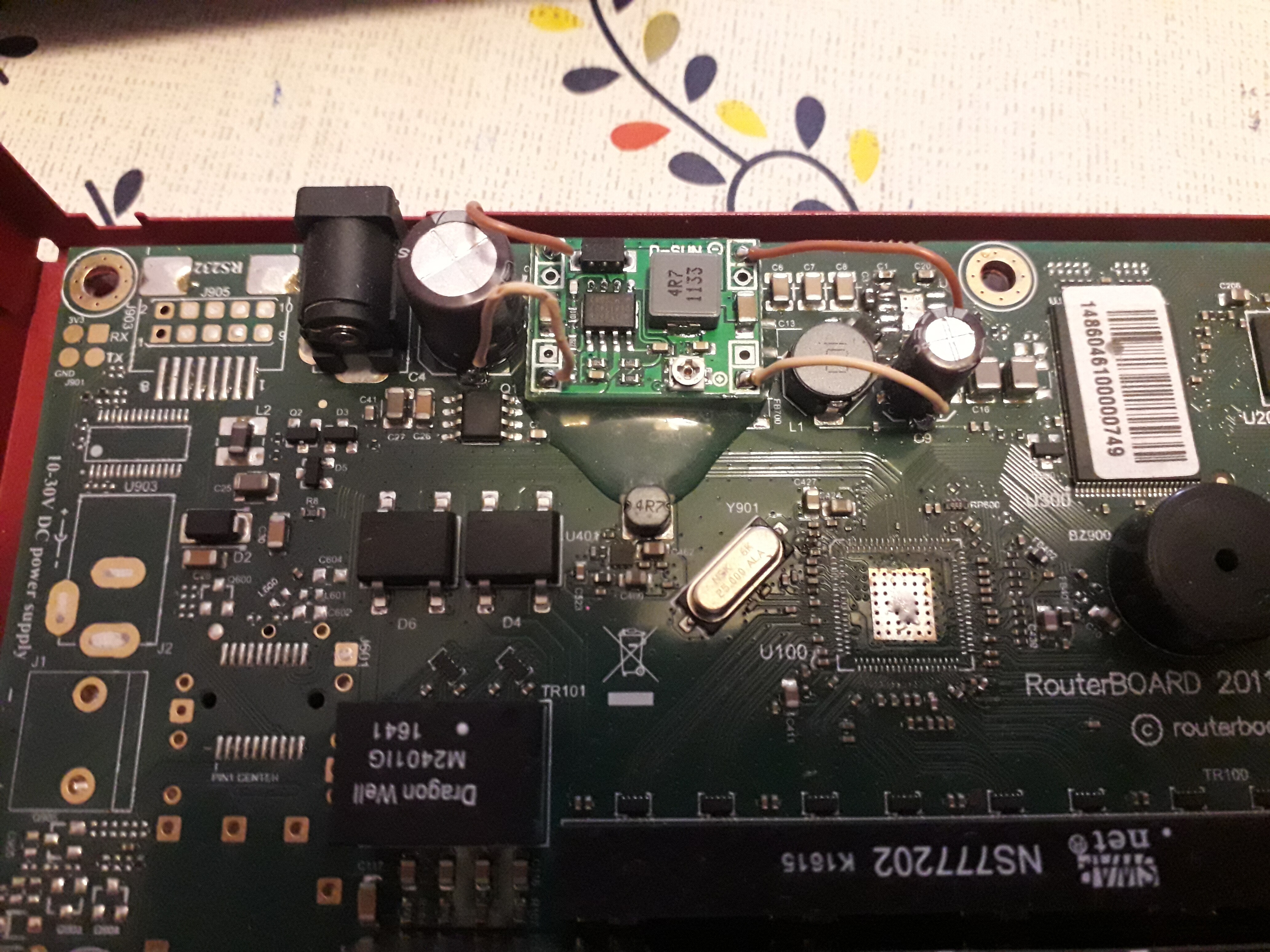

Here’s one i repaired, the primary Dc/Dc controller chip fried, and since i hadn’t the correct one to replace, i replaced the PSU stage as a module.
It takes +24v from the BIG capacitor, and delivers 3.3 (actually, 3.45-ish) to the small cap.
