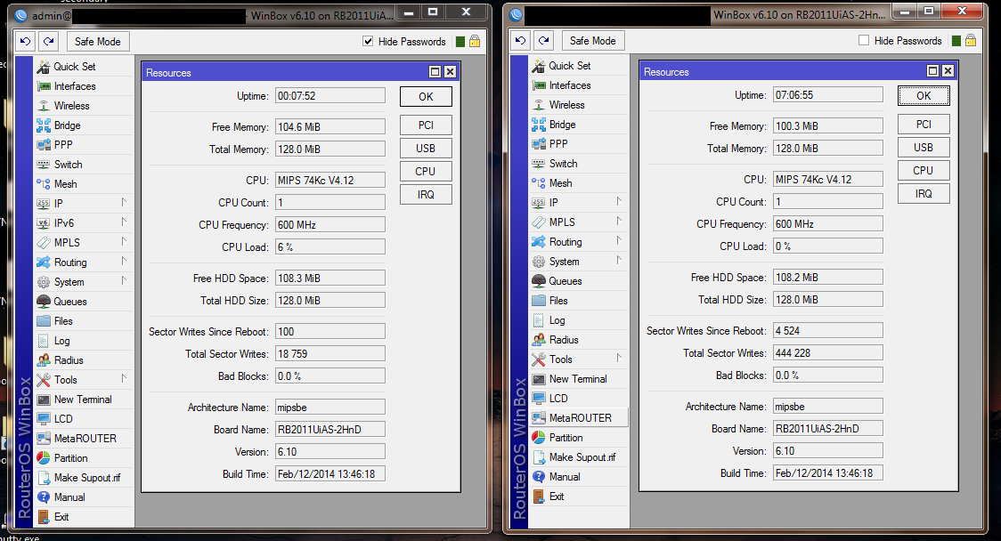

Two RB2011UiAS-2HnD-IN units, different CPU Utilization on idle, both has default factory settings
What causes the other RB to use 6% CPU while the other is zero?
One have IPv6 enabled, and try to obtain IPv6 info on the net…
IPV6 package is not installed.
identical configuration side-by-side
i just didn’t make a new screen shot
You sure?
yes, it was installed, but i already removed it, I thought that was the cause too. the CPU still hitting 5~8%

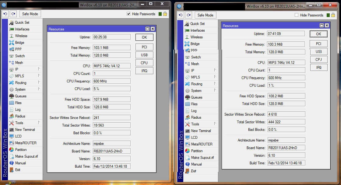

done the netinstall + 6.7 + 3.14 - still the same

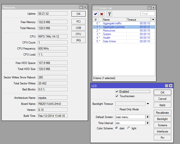

turning OFF the LCD on one unit dropped the CPU to zero while on the other RB with 6.10 + 3.12 has the LCD turned ON and the cpu usage is 1~2% only.
reverted back to 6.10 + 3.14,
solved the problem, it was not from the package or firmware,
disabling and re-enabling the LCD 'Aggregate Traffic" dropped the cpu to 0-2%
probably a bug while RB is collecting stats for lcd display?
