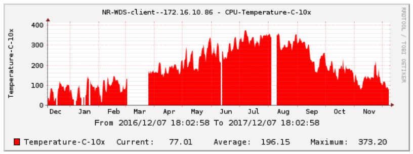

Somewhat related to clock speed & heat
Here is a year-long graph (from my cacti graphing system) for an outdoor Mikrotik. It is a 922UAGS-5HPacD running at 720 MHz.
The temp graph is x10 (devide by 10 to get the corrent temp)
