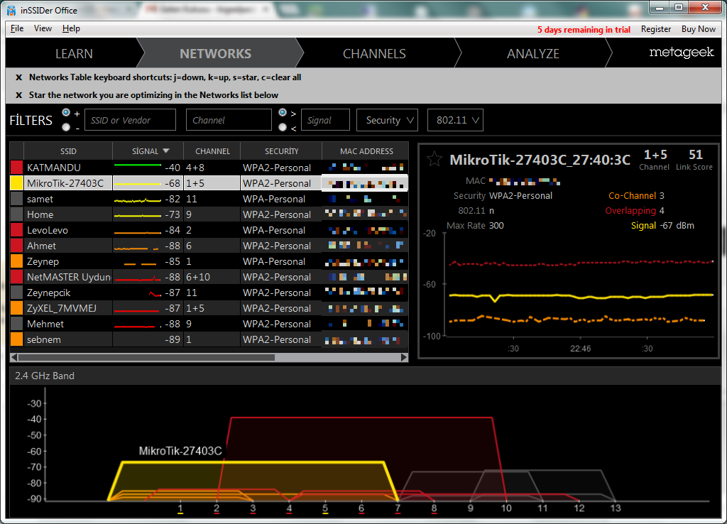

Today I bought rb2011UiAS-2HnD today for a small hot spot project.
But even build in basic configuration (WISP AP mode) I can not get enough wireless signal.
Router is near my laptop (on the desk) and i can only get -68db signal. Not only my laptop, my other wireless devices also almost have no signal from mikrotik. Signal almost reaches 5-6 meters away. That’s all.
İn the inSSider screenshot, SSID KATMANDU is in the same room with mikrotik and laptop. It is a cheap tp-link AP. Other SSID’s are my neighbors. (Living in an apartment building)
Does anyone have an opinion?
Thank you…

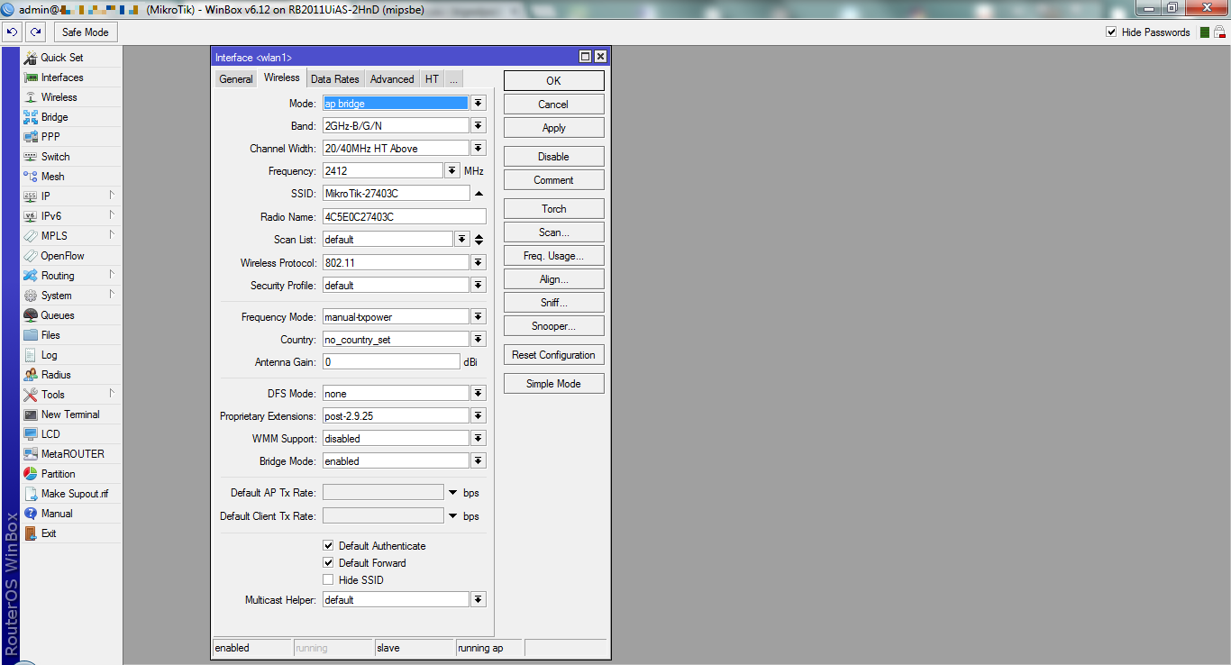

Could you set frequency mode to “regulatory-domain” and Country to your country. And on the HT tab, select all chains as TX and RX and on the TX Power tab to default and see what your signal is?

Device has ROS 6.12. And I checked and try almost everything include HT settings. BG mode only 20 Mhz , Fix TX 30 Dbm etc..
In HT settings nothing changes any result.
