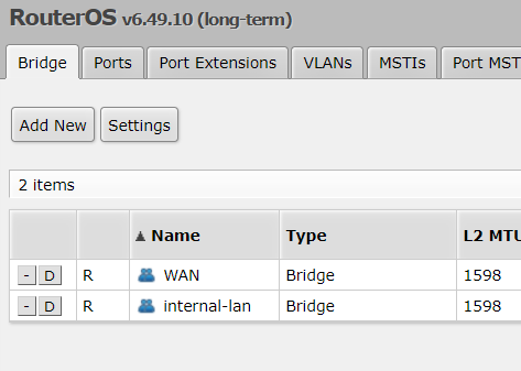

I have RB2011UiAS-RM for a long time and I upgraded my Internet connection to 1gbit, the internet speed test on the modem is ok (960 mbit/300 mbit), but passing through the board the speed goes down to 240Mbps.
I have two bridges configured 1 for WAN and one for Lan.
I checked all configurations but I think all is ok (but ask me if you need more details).

There is not much you can do. You may see some small improvements if you remove the WAN bridge (do you really need it?). Or you can gain a tiny bit for improving the firewall rule order..
