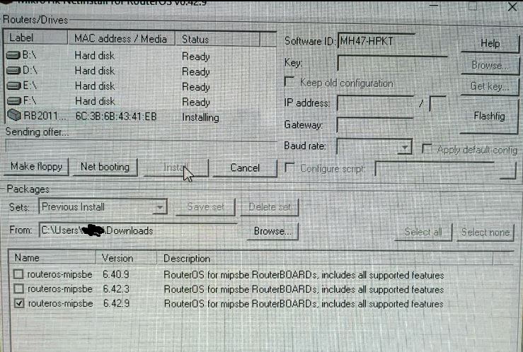

Hello All,
I hope you are all are doing great. I have a strange issue. I upgraded the router from the packages menu and now my router2011uias-rm is in boot loop. However I tried to install the OS via netinstall. But this is causing a strange issue. The router shows itself on the netinstall, when I click install, it does nothing, nothing at all. I have also made a small video. Please guide me what I am doing wrong.
video link.
https://yadi.sk/d/RGtgXZb_8-RZ2A/VID_20181012_230040.mp4
Regards,

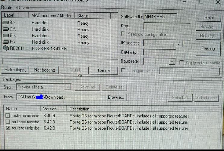

Please check these pics
It flashes Installing
and after that nothing happens it stays on this position.
Will anyone please help
Issue solved,
I changed the PC and it worked as it should.
