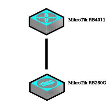

I made a configuration error on the RB206G forcing me to use the reset switch to restore the device.
After restoring the configuration, approximately 15 seconds after plugging the switch back into the router, the management interface on the switch became unreachable. Approx 15 seconds after removing the router to switch connection the management interface was restored.
Unreachable meaning pinging the interface is stopped responding and the web interface was to accessible.
I replaced the switch with a second RB206G fresh from the box, giving it the same configuration as the first switch and the anomaly didn’t exist.
I saved the configuration from the second switch to my PC and restored it to the first switch. The anomaly went away.
Thinking I was full of S&^% I reset the first router using the front panel switch. Sure enough when I plug it into the router the management interface drops after 15 seconds. I used switch two configuration file once again to restore switch one and the anomaly goes away.
What configuration does the reset switch fail to restore in the switches setup that impacts the management interface?
