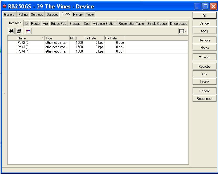

I’ve now got the switch so that Dude can see it. I’ve got Port 1 plugged into a 3Com 3300 and port 5 plugged into a RB750.
Dude sees all 5 ports but as soon as Dude starts actually probing the unit some of the ports disappear.
I suspect it may have something to do with the fact that the switch’s IP address is 192.168.65.84 and it’s on a /29 subnet, while the Dude Server’s IP address is 192.168.65.2 or a /30 subnet.
As you can see from the screenshot in Dude, the ports that are connected are just gone.
Just to make things a little more interesting, when I use MRTG and PERL to SNMPwalk the switch, interfaces 1 and 5 are there and can be read without any problems.
This could be an issue with Dude.

Do you make regular SNMPwalk from the Dude?
We have added SwOS device to the Dude, it is monitoring and 5 interfaces are shown.

    5 interfaces are still displayed and snmpwalk returns 5 interfaces.
Yes, I can SNMPwalk it no problems.
What version of Dude has SWOS? I can’t seem to find it in the 3.6 that I’m running.
SWOS does not have any Dude version.
I’m running 4.0beta2 Dude, interfaces are displayed correctly.
