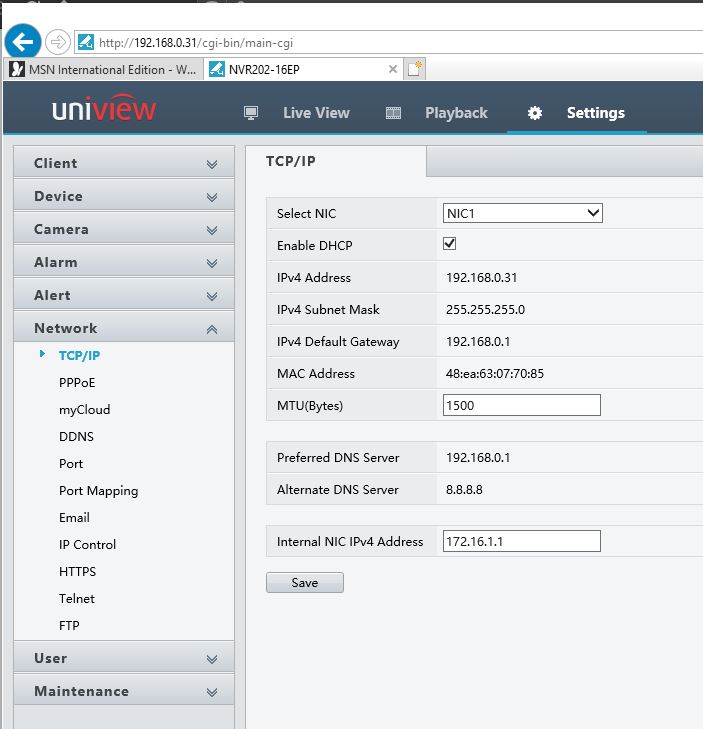

Form the NVR’s network settings, I can set if it takes the public IP address by DHCP or static, and which address to use for internal NIC.

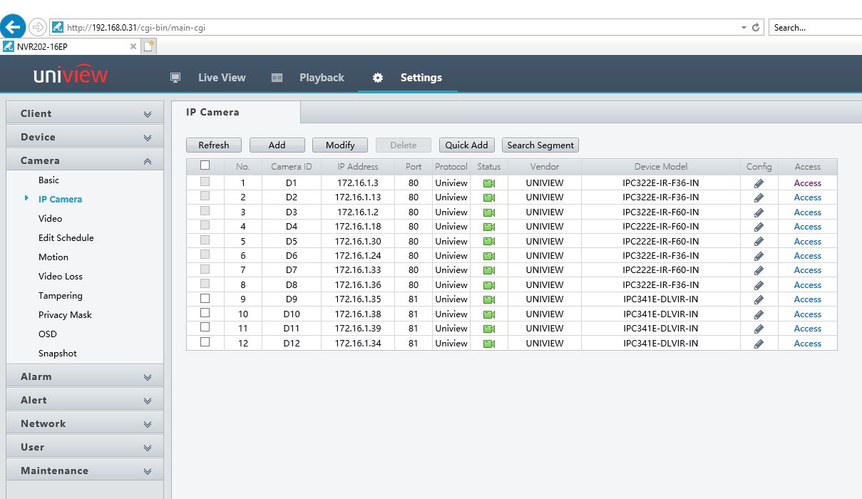

The list of the cameras behind every NVR is manually built, and the cameras have static IP’s.
Then every NVR runs DHCPD on the internal interface - there is no setting to stop this behavior. NVR’s allocate IP’s in the same network like their internal NIC IP.

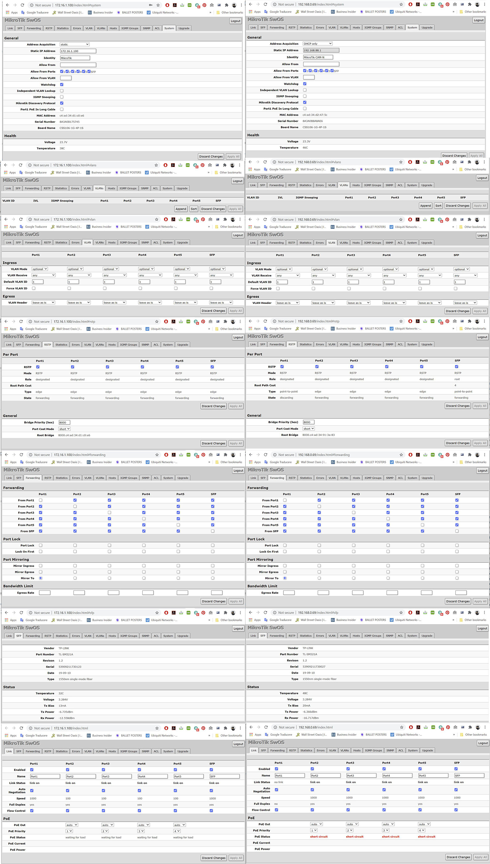

I made comparing screen shots between the two switches.
The one in the left is the problem. The one in the right is working normal…
I don’t see anything that jumps out at me that would cause the problem that you are seeing. About the only config change you may want to try (although it should not matter) is to change the NVR and FO connections on the VLAN tab to VLAN Mode = Disabled and VLAN Receive = Untagged Only. May also try under Egress, change VLAN Header to Always strip. That gets your untagged ports configured exactly the way I have mine - however I am running VLANs on all of my switches, so a little different environment… As I said, that should not make any difference.
