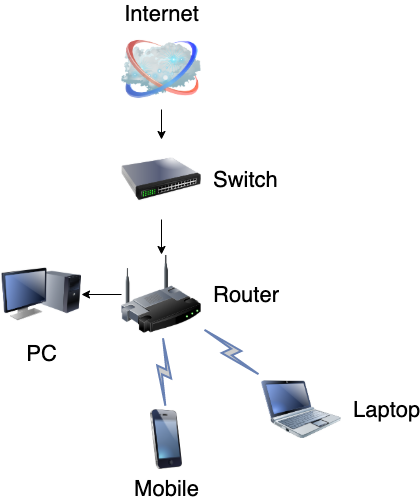

In my apartment I have such case:
ISP: as ethernet input, only one MAC is allowed;
Switch: in past router as a bridge, now it’s RB260GS;
Router: hAP ac, clones MAC, spreads internet to iPhone and MacBook, also there is wired connection with PC.
I’ve restored the router to factory defaults and made the setup of wifi, and set IP as 192.168.88.1. DHCP is on.
IP of the switch is 192.168.88.2.
Problem: there is no internet, also I can’t ping the switch from the router or PC (but the router sees the switch as neighbour).
Maybe some configs are necessary, for example, firewall rules or IP routes, I dunno.
Any thoughts?

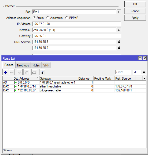

Now, I wanna replace Automatic Address Acquisition with Static (cause I know IP, netmask, GW already)
BUT, after doing that Internet is going off.
Tools → Ping: can’t ping 176.36.0.1 (ISP GW)
I’ve checked:
  1. IP → Routes, everything looks ok
  2. IP → DHCP Client, ether1 disabled
  3. IP → FIrewall, rules are same

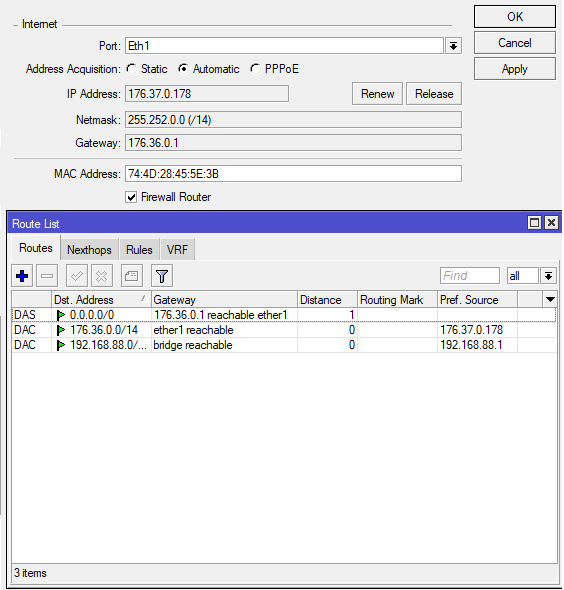

Automatic:
Static
Maybe your ISP’s router is miffy about talking to anything that hasn’t gotten its address through their DHCP server.
Was talking with ISP support, they asked me to use Automatic Address Acquisition.
In this case, can I use it AFTER switch?
What is the purpose of this switch? Or there any wired devices connected to the switch? Does it work when you only connect the router?
The address on the router is LAN side while the switch is connnected on the WAN side. That doesn’t make sense…
The purpose is a little bit funny.
I need to connect the end of the ISP cable with my router using extra solution, cause router is to far from the end of ISP cable.
Of course, I can use one more router, but I haven’t it. Don’t wanna buy it, if I can use the switch just to pass internet to the router
