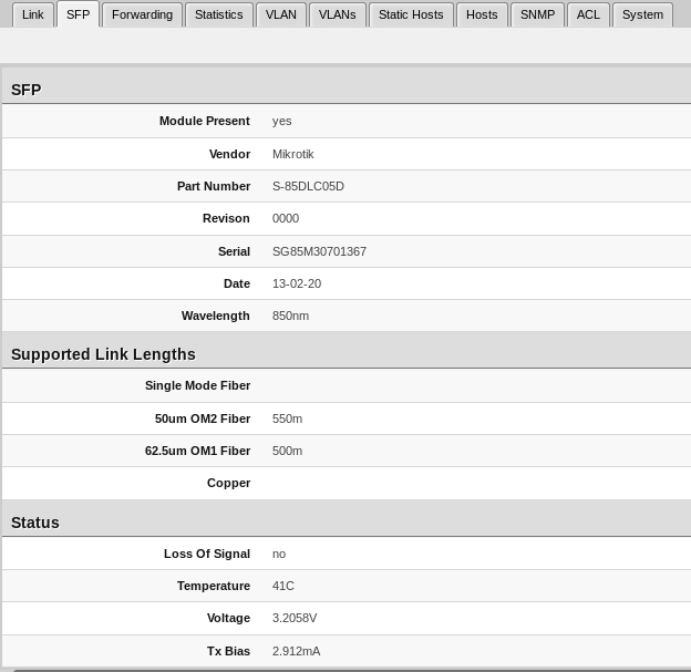

RB260GS with fw 1.9 is connected to Cisco C3508 L2 switch via the metallic GB line. Attempt to replace line with SFP S-85DLC05D - to - Cisco GBIC WS-G5484 connection was unsuccessfull. Line was seen as active from RB point of view (green SFP indicator lit) but no data went through the line.
Similar situation is with S-85DLC05D connection to TP-Link MC200CM media converter. Both devices indicates that line is ok/up, but no data goes through.
Screenshot from SFP tab is attached and output from Cisco CLI contains row “Auto-duplex (Full), 1000Mb/s, media type is SX” in description of particular interface.

Solved: problem was related to defective SFP module. Confirmed by the service personal of dealer company.
Hi I have exactly the same problem with S-85DLC05D and TP-Link MC200CM, was this also problem with S-85DLC05D SFP module?
It was SFP..
